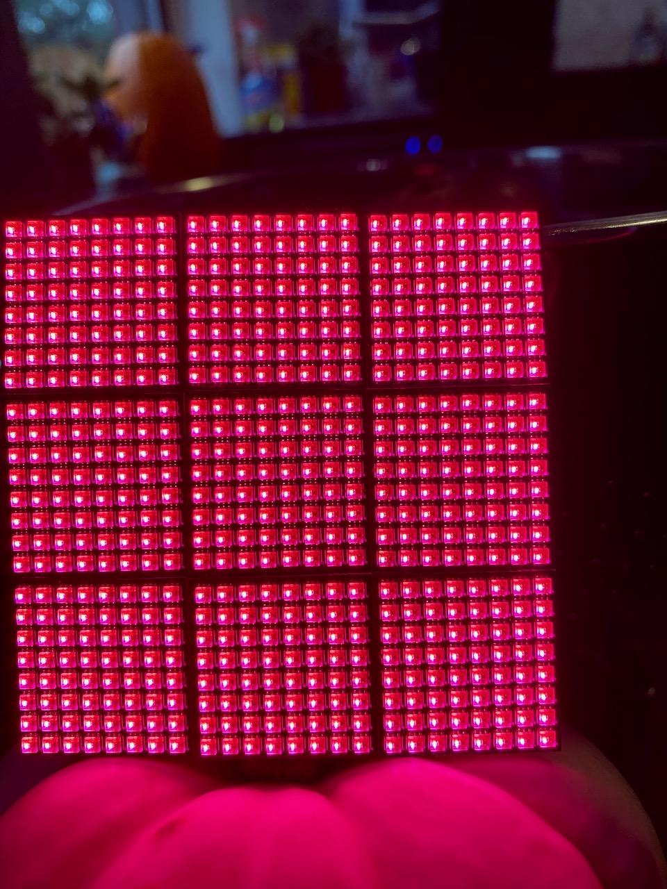

My first big challenge was to figure out what type of LEDs to use for my Lady Gaga mask, and how to make the sine wave animation on the front. I was lucky enough to find a post by a company called Smooth Technology - they were the creators of the original mask, and they had posted a process shot to their Instagram. This showed me that it was in fact a matrix of DotStar LED matrices from Adafruit, not an evenly spaced, single LED matrix. I also learned what microphone they used, and I used the same. You can see links to these in the supplies list.
Step 2: Build the Matrix of Matrices Display
Now that I had the example from Instagram, I made sense of it by sketching my own plan in my notebook. My first task was to clip the mounting holes off of the matrices with wire cutters and sand the edges so that all 9 matrices would sit flush together perfectly.
Step 3: Solder the LED DotStar Matrix
I taped the matrices to a piece of cardboard to keep them in place and soldered them together according to my diagram. I also added the microphone and an Itsy Bitsy M4 Express to control the display.

I followed the Adafruit DotStarMatrix Library setup tutorial to test and orient my matrix correctly.
It was helpful to test with a color wipe to be sure that all pixels were operational and showing in the correct order. This was a bit of a tedious process but the tutorial helps with this.

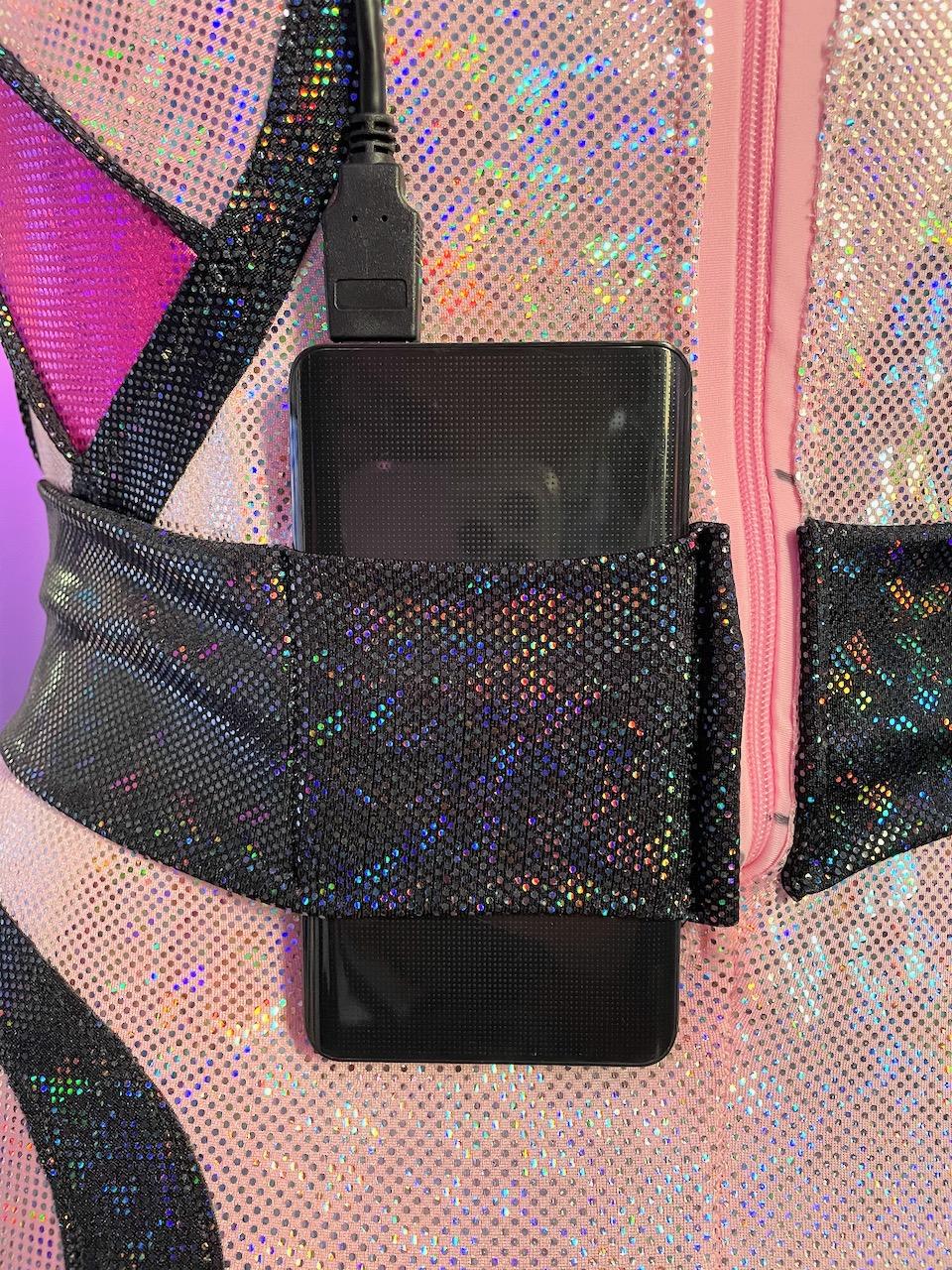

I glued the two side pieces to the matrix box and sewed those side pieces to the main mask piece. While sewing, I created a path for the power cable to escape on one side so that it could run down my back to a battery pack sitting inside my belt.

I added a standard USB battery pack to my belt and plugged in the mask.
