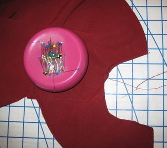

Step 2: Fabric Layout & Cutting
Step 2: Lay out your pattern pieces to ensure that you have sufficient yardage. Cut out all pattern pieces.

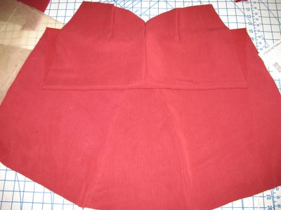

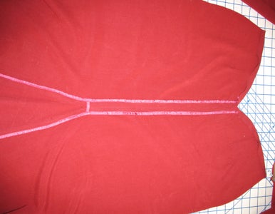

Step 3: Back Skirt Seam & Godet
Step 3: Insert godet between lower half of two back skirt pieces. Lay the triangle shaped godet flat against one back skirt piece and stitch, followed by the other side. Then sew up the center back skirt seam.
Step 4:
Step 4: Finish the center back seam and godet by encasing your raw edges with rayon seam binding.

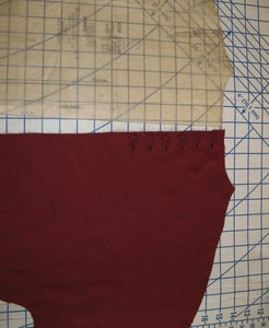

Step 5:

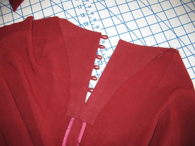

Step 5: Create a length of bias tubing with your fabric. Cut a length of fabric on the bias, fold in half (right sides together) and stitch. Trim the seam to a width that is just a smidge narrower than the loop. Using a loop turner, turn the tube right side out. Cut your bias tubing into equal lengths that will accommodate your buttons plus approximately ½”.
Step 6: Hand baste the raw edges of each bias tube end to end, forming a loop. Apply each loop at each button point, raw edges facing the raw edge of the bodice back. (It is okay if the raw edges do not reach the fabric edges – just make sure that those edges are within your seam allowance.)

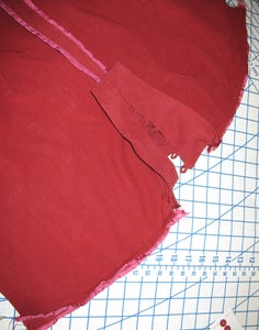

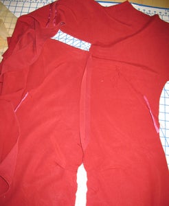

Step 6:
Step 7: Right sides together, stich center back seam together below opening. Finish lower back edges with seam binding.
Step 8: Stitch the bottom edges of your back facing together. Finish the outside edges of the back facing.
Step 9: Right sides together, stitch back facing to back bodice along neck and back opening edges, making sure to catch the raw edges of your button loops within the seam allowance. Trim seam allowances and turn right side out. (If your facing is a different fabric from the dress or does not hold a crease well, you may want to under-stitch the seam allowance to the facing.)

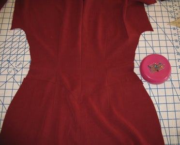

Step 7:
Step 10: Edge-stitch the skirt back to bodice back. To do this, press under the seam allowance on the back skirt and lap this fold at the stitching line of the bodice back. Baste and stitch. Finish raw edge with seam binding, being careful not to catch the garment.

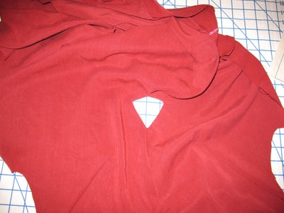

Step 10:

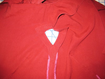

Step 13: Stitch front diamond facing to front bodice, cut out diamond, turn, understitch, and press.
