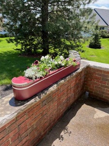

Once the paint was fully cured, I added the plastic gutter and cut in a hole at the base for the drain line. The drain and gutters were caulked into place with the OSI quad as this is one of the best exterior caulks available. But you can't tool it so you can see in the following pictures where I didn't hold a perfect bead on the side of the gutter as I was sealing it. Oh well, plants will hide that. Hopefully no water ever gets under the gutter or drain, but if it does, it still has 4 layers of paint to stop it from getting to the fairly waterproof wood underneath.

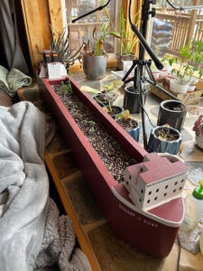

Hand painting these was painstakingly difficult. I am ok with how they came out but not happy. I am not good at painting crisp lines with tiny brushes. You know honestly, I am not good at painting crisp lines with any brush. But I tried to capture as many of the details as I could. Port holes, windows, doors, decks, stripes, smoke stack designs, lettering on the sides of the freighters, even the #1 on the boat that was the first 1000 footer on the Great Lakes. I have a new found respect for people who create miniatures and enjoy hand painting all the fine details. This is not a hobby I would want.
Once all were hand painted and completed, little rubber feet like you use on a cutting board were added to the bottom so the base could breathe and not trap moisture on whatever ledge it was set on.

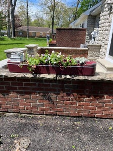

When I was finished I had to get them to my sisters and mom. I was going to deliver all 3 at Christmas, but it is hard to hide what they are. How do you carry a planter that weighs like 25 pounds and wrap it in something that looks like a regular present. Well I didn't figure that one out, so I wrapped them in some foam and wrote Not a boat on them. I mean they are planters so it should work theoretically. In reality, they seemed to have sorted out that the "not a boat" message was a half truth. They were really excited though about opening them and the anticipation was fun.
Overall I think they were a great success and two of the three have now been planted. One is inside on a windowsill as they didn't want to chance the weather. One made it onto a porch with some beautiful flowers, and the other isn't sure they want to plant it and it may live inside on a shelf with fake plants.
