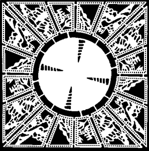

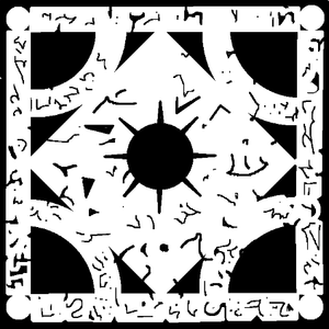

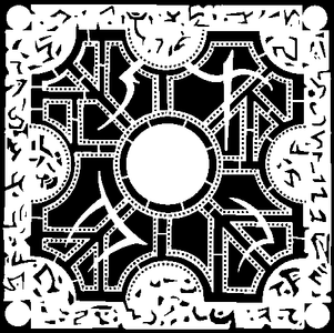

Use Easel to engrave the black and white images attached to this Instructable onto the veneered squares.. I used a 0.8mm Dremel engraving bit, but a V-bit with V-carve would probably create great results.
4:23 Before importing an image, I set the bit size in the new Easel project to 0.8mm, and set the units to mm.
4:39 To import the image, click on Import -> Image trace. Click on Upload file, and choose one of the black and white images. Adjust the smoothing until the preview stops looking jagged. Click Invert, because the white areas in the image need to be recessed in the engraving.
5:09 On the Cut tab, set the cut depth to 0.2mm, and on the Shape tab, scale the imported design to 79mm x 79mm, with an X and Y offset of 0.5mm.
5:35 If you have an X-Carve or another GRBL CNC router, you can set up a square in the machine and cut right now. But if, like me, you are running another flavour of CNC router, you'll need to download the G-code. I made another Instructable to support this one, which goes into a lot more detail about how to run Easel G-code on other sorts of CNC machine: https://www.instructables.com/id/Run-Easel-Gcode-on...
5:57 Set up a veneered square on the bed of your CNC router. I used double sided tape to hold the squares down. You could use a vacuum table. As I stuck them down, I used an engineer's square pressed against the Y axis to make sure the wood was lined up with the axes of the machine.
6:05 Following the previous Easel / CNC steps, engrave 2 copies of each of the 3 designs, making the 6 sides of the box.
