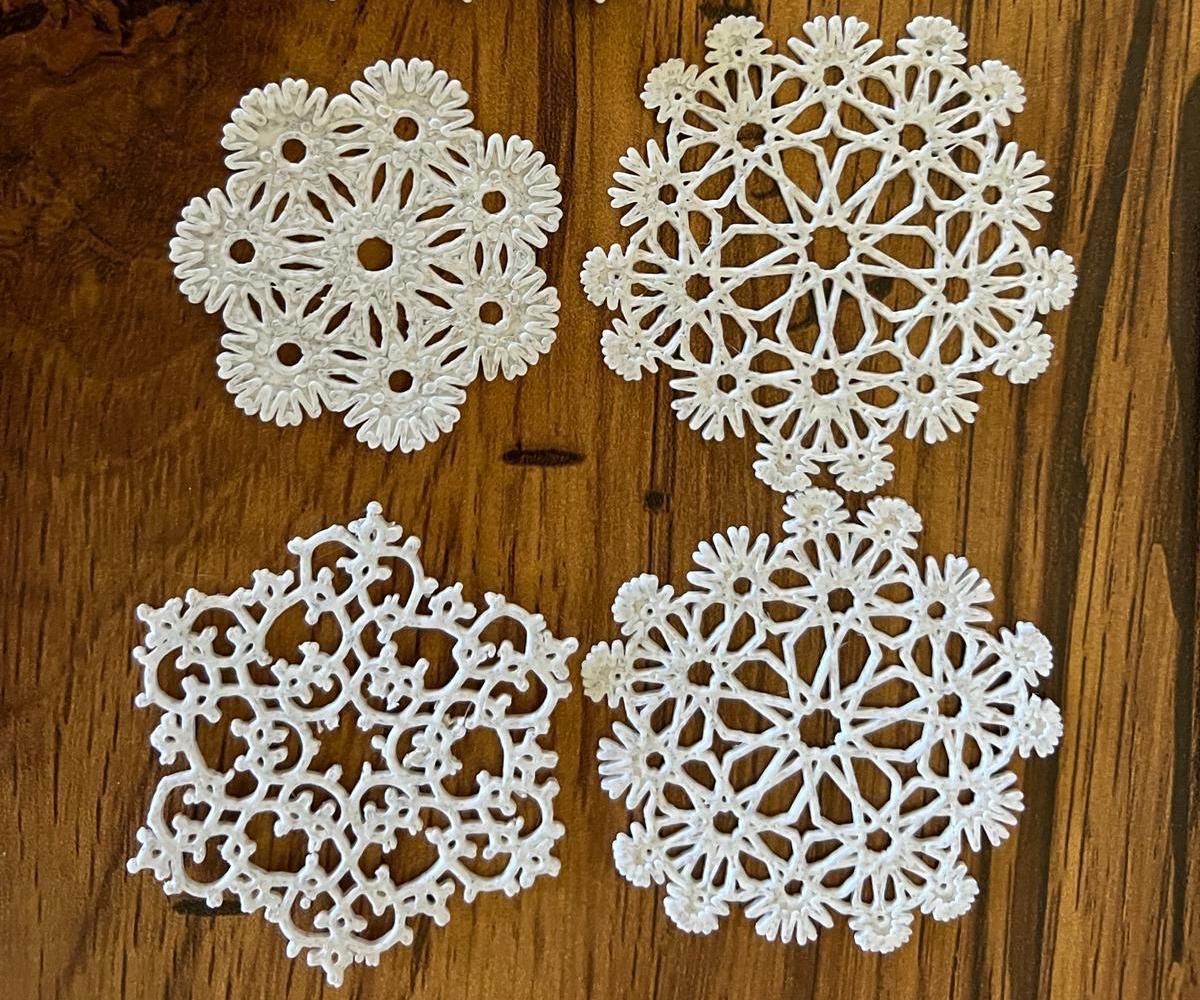

The panels were design with the idea of being easy to assemble and remove. They have flaps at the sides to be placed from inside of the lamp with the designs looking to the outside.
  1. design shape and extrude it 1mm.
  2. use array tool to create a rectangular array of the shape.
  3. preform Boolean union to all the array of shapes.
  4. place array on top of the frame.
  5. preform a Boolean slit to "cut" the array pattern as the frame.
  6. cap all surfaces that might have been open.
  7. preform Boolean Union and export.
