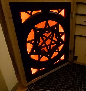

Going through a craft store I found this wooden book box. I immediately bought it on an impulse believing that I had found the perfect project to replace the lamp on my nightstand with.
Without much planning or sketching I started to put together the functionalities that I wanted this lamp to have.
I wanted it to:
  • Create a light that I could dim and brighten easily.
  • Have it change colour through hidden switches.
  • Have a secret button that opened a small compartment for me to store my rings in.
  • Have the secret compartment to only be accessible through finding another secret button.
Considering that I am wildly out of my depth here and it being my first time using an Arduino I thought that this would be quite a challenge already. Spoiler. It was.

At this point it was time to start building everything into a solid housing. Truthfully speaking this has taken up a significantly larger portion of time then I anticipated.
Not only is it a challenge to do this on its own, but disaster would also strike on several occasions. After I had already closed up the compartment around the Arduino, the cable that grounded everything broke. The button for my puzzle mechanic snapped off. And my first attempt at creating a window pane was extremely lumpy.
Despite this I got everything roughly into place. After I made sure everything still worked correctly I started to close up the housing completely. Apart from the cables that run from one side of the book to the other all electronic components have been covered.
