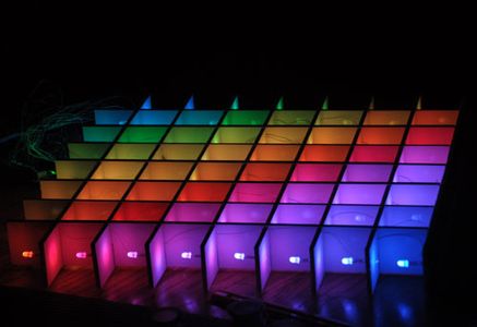

Each of the 64 LED's in the matrix is enclosed in a 2x2x2" cell.  First, draw out your cutting lines in pencil on your foam board. You will need 14 grid pieces to form the core of the matrix. I found that it's convenient to lay out the cuts in pairs that are facing each other.  This way, you can cut two slots at once.
Cutting foam board requires a very sharp knife.  I used a #11 X-acto blade.  If your knife is dull, instead of cleanly cutting through the foam, it will just catch on it, ripping out little chunks of foam.  It's not very pretty.  I went through 3 blades while making the matrix.  Change the blade when the cuts start to get degraded.  I found it hard to make a single clean cut through the 3 layers of the foam board; this method often left me with little chunks of ripped out foam.  It's easier to make clean cuts if you first make a deep score with the knife against the straight edge.  Make sure the score goes through the whole top layer of paper, and into the foam.  Then you can remove the straight edge, and just run the knife repeatedly into the score until you get through the layers.
First, cut the slots.  You can pop them out at this stage, or wait until the next step.
Step 3: Cut Out the Grid Pieces
Next, cut the grid pieces apart with your x-acto knife and straightedge.
Step 4: Cut Slits in the Grid Pieces
Cut horizontal slits into the grid pieces, one in the center of each cell.  Make sure the slits go through all the layers.  You needn't be super precise, but they should be about 1/2" long.  The LED's will be held in place in a later step by pressing the wires into the slits.
Step 5: Assemble the Grid Pieces
Assemble the 14 grid pieces to form the core of your matrix.  Don't glue it yet.  You might have to take it apart several times while wiring it up. I painted over the printed bits with white spray paint before proceeding.

Step 8: Thread the LED Strands Into the Matrix
Thread the LED strands into the gaps between the grid pieces.

Step 12: Finish Constructing the Matrix
After the wiring and testing is done, you can attach the top, bottom, and sides.  Note that there is an 3" long extension of the side pieces on the bottom.  This is to accomodate the Colorduino.

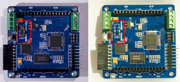

Step 15: Colorduino Description
An Arduino doesn't have enough I/O pins, nor enough current output to drive an 8x8 RGB LED matrix. Therefore, one needs to interface it with external LED driver circuitry.  The Colorduino is an Arduino variant, which is specialized for driving up to 192 LED's (64 RGB LED's).  For a detailed description of the Colorduino, see my article, Itead Studio Colorduino - A Preview.  Note that my Colorduino is a beta board.  The production version, V1.3, has been released to manufacturing.  It contains some minor tweaks, such a repositioning the ICSP header to a location that actually has enough space for you to plug in your programmer!
The Colorduino can be powered by 5V via the 8-pin header, or with 6.2-7.5V via the 4-pin green screw terminals.  When switching between the two power sources, it is important to put the slider switch in the correct position.  The Header position is for power through the VDD pin on the 8-pin header, and the Terminal position is for power via the VCC pins on the 4-pin green screw terminals.
The LED's draw a lot of current.  When I powered the Colorduino with either my Arduino or my USBtinyISP, I was not able to program it, because the LED's draw too much current.  Switching to a separate 5V 1A supply fixed the problem.
On drawback of using a dedicated board such as the Colorduino is that it doesn't expose any I/O pins for external inputs.  Therefore, many users connect them to another Arduino via I2C.  Since I'm using it standalone, I connected my input to one of the I2C pins. There are actually a couple of other free I/O pins, such as INT0 and INT1, but they are not connected to any accessible headers, so you have to solder wires directly to the ATmega MCU to use them.

mmdonaher
mmdonaher
8 years ago on Introduction
I finalllly finished wiring and building everything and testing my LEDs and power supply today. I was planning to power the array from the screw terminals, but when I went to attach the power supply I realized the colorduino I was sent did not have a switch to slide between "header" and 'terminal" power sources. I was able to find a picture of both (so clearly they manufacture it both ways?) and have included it below. The one on the left is what every tutorial seems to depict and somehow I ended up with one like the righthand picture. I was curious what to do in this situation- will powering it through the terminals without the switch in place cause a problem to my the Colorduino or my LEDs?
0
mmdonaher
mmdonaher
Reply 8 years ago on Introduction
I heard back from iTead and their reply is below:
"We
have soldered 0R resistors on that position of the switch. You can add 9V
or other power supply on VIN pin."
I powered my array with 6V 1A through the screw terminals and it works perfectly.
