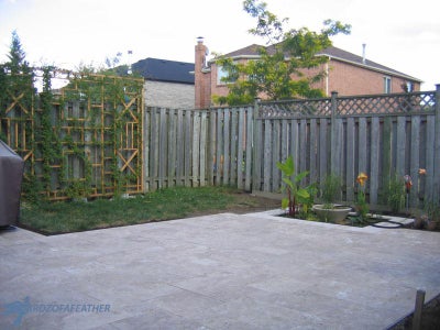

When we dug up our yard for the patio, we left a small patch of grass as you see in the 1st pic.
The trellis you see leaning up against the fence in the 2nd pic will eventually flank our dry creek bed.
After finishing the stone patio installation in our backyard (3rd pic), that lonely patch of grass in the back left corner stuck out like a sore thumb. It didn’t really make sense to get out a lawn mower every week to mow such a small area; not to mention how awkward it would be to maneuver it past our patio set! More importantly, not using electricity to cut the grass – or water to keep it green – is the sustainable way to go!

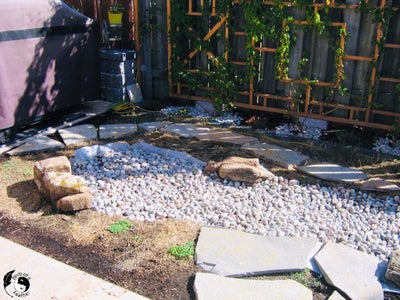

Once the juniper was planted, we added landscape cloth along the bottom of the bed and up the sides to prevent weeds from growing. We extended the landscape cloth a few feet over the edges. That's so we could run it under some larger boulders we planned to place around the bed (which you'll see in the next step). In areas we weren't planning on putting any boulders along the sides, we simply folded the landscape cloth under and staked it into the sides of the dry creek bed to prevent it from shifting.
When the landscape cloth was secured, we started filling the bottom dry creek bed with a colourful variety of smooth river rock. We extended the rocks around the pom pom juniper and along the side of the pond too.

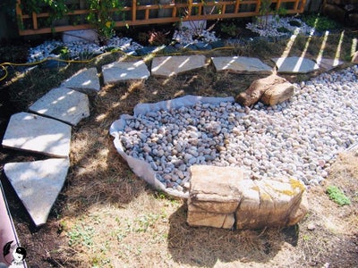

Step 4: Lay Stepping Stones
Stepping stones not only outline the shape of the dry creek bed, but they provide a practical solution to walk around and a landing pad to train our silver lace vine vine growing beside it as it gets bigger.
We handpicked the pieces at the stone yard that we thought would fit best. When shopping for flagstone, take along a sketch of your plan to help you visualize the space!
While we were at it, we also purchased some larger decorative boulders for the rock garden and a few extra boulders to sporadically place around the sides of the dry creek bed. When we got the stones home, we were excited to do a dry lay on-site to see how we did with our selection!
You can see where the landscape cloth extends over the edge of the dry creek bed and is held down by some of the flagstone pieces. We'll eventually use this 'landing pad' as a base to level one side of a wooden bridge that will span across the dry creek bed (last pic). We haven't gotten around to building that yet, but Rome wasn't built in a day :).
You can fill in the gaps with some pea gravel, but we chose to fill them in with dirt so we could plant moss in between and around the stones (as you'll also see further ahead).
Take your time with the dry lay of the stepping stones and boulders to make sure they are aesthetically pleasing as well as functional!
Once happy with the placement, we dug around each stone with an edging tool and removed the grass as well as a few inches of topsoil. The goal was to inset the stones slightly below the surface to keep them in place and prevent shifting during colder weather.

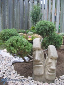

Where the dry creek bed ends, we found the PERFECT statue to accent the pom pom juniper. We trailed the river rock from the dry creek bed around the ornamental juniper and in front of the statue ending it beside a pond we installed when we constructed our stone patio installation.
The statue represents a tragedy and comedy mask; a great reminder of all the hard work - with all its setbacks, humourous moments and cold cereal for dinner. But we wouldn't trade building our garden from the ground up for anything! It's our sanctuary :).
As you can see in the last pic, the pom pom juniper has had a chance to grow around the statuary! These days we have a lot of fun with it; it's now sporting cheap sunglasses (🎶 Gotta get yourself some cheap sunglasses)!

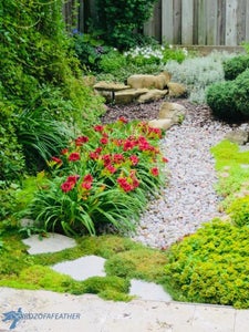

Step 9: Transformation
The south-east corner of our backyard went from all grass with a few dead plants, to a lonely patch of grass, and finally to a lush section of our surburban oasis.
For the time and effort we expended up front, it's certainly a big payoff in the end. It's far more interesting to look at than a patch of grass - and requires very little maintenance to maintain it!
The only care it needs is a seasonal trimming of the ornamental juniper to maintain the round shape of the pom poms. The silver lace vine also needs the occasional trim but now that it's established, it's pretty low maintenance too.
To finish the area around the dry creek bed, we covered the narrow pathway between it and the fence with mulch. Mulch keeps the mud and weeds at bay.

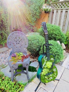

Until we can build out bridge to complete our vision, our dry creek bed is a wonderful backdrop for our hypertufa chair and guitar planter!
