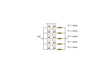

LED pairs are going to be connected in series with a resistor. Each pair will then be wired in parallel. Install a pair of LEDs and bend the legs to connect the positive leg of one LED to the negative leg of the other creating a pair with a single positive and negative leg. Apply some solder to the join to secure the pair together. Continue until all the pairs are installed.
A resistor will be added to limit the current applied to each LED pair ensuring only a safe amount will be supplied. This will ensure your LEDs lives are not tragically cut short and you can enjoy the LED benefit of longer lamp life. Clip the negative leg and resistor leg to around 5mm in size and solder. Repeat for each pair. Although it doesn't matter which way you attach the resistor, I'm a stickler for installing them all in the same orientation. You can now test each LED pair using the 6v battery for the torch.

We now need to connect each LED pair in parallel which basically involves soldering all the positive legs together to make a single positive leg and the same for the negative. Bend each positive leg over to connect to the one next to it, clip them to size and solder them together until only your single vertical positive leg remains. When connecting the negative legs, ensure you're making the connection after the resistor so you don't bypass it. Adding the resistor raised the height of the negative legs allowing you to make connections over the top of your positive ones easily. Be careful not to accidentally connect any of the negative and positive legs together as your light won't function.
Once all your pairs are connected in parallel and you have a single positive and negative, connect a wire to each and extend these connections. It's not a bad idea to insulate the solder points for these two wires with some tape or heat shrink tube. Test your light with the 6v battery and ensure all the LEDs light up. If they don't, examine the connections to the LEDs that didn't light. Run the two wires through your reflector and secure the disc in with some glue. You now have a completed LED lamp ready for installation.
