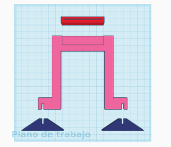

Step 1: Finish Line
To arrange micro:bit and electronics in a convenient way, we are going to design a finish line that we will print on plastic with a 3D printer.
The upper piece will accommodate micro:bit and it will allow making the connections in a very simple way as we will see in next step.
