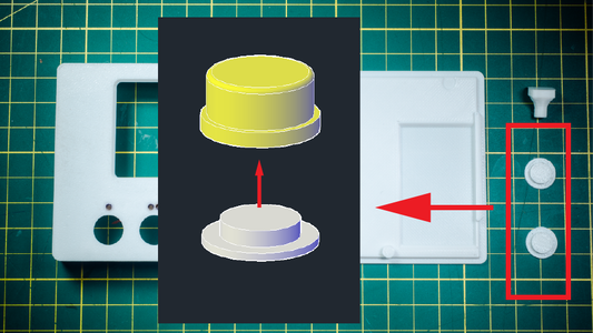

Step 1: Preparing the 3d Case
After 3d parts are printed, it is required to complete its preparation before assembling LCMini. This includes:
- Install brass inserts for pcb screws - Use M2.5X3X3.5mm brass inserts. For this you don't need any fancy tool, just use a solder tip as shown in here
- Prepare buttons caps so they fit the case - Remove internal plastic of the button so you can fit the 3d printed spacer. This will give the button the exact height to fit the distance to pcb when assembled.
