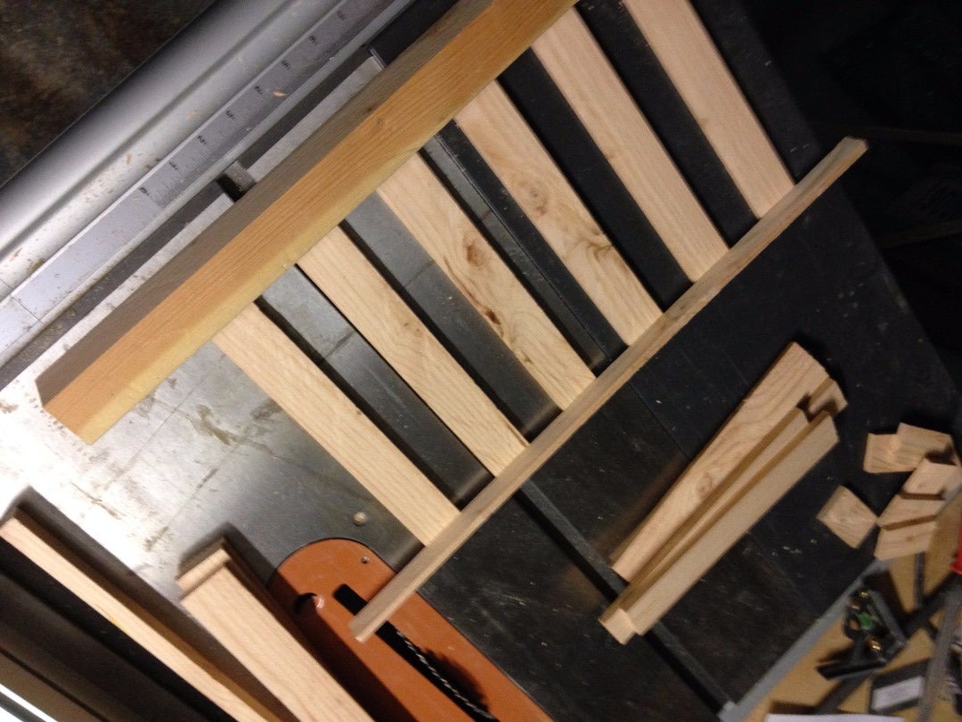

Step 2: Cutting the Stock
I set the fence from the table saw blade to 1/4" and cut off 7 strips (1-1/2" W x 1/4" T x 24" L)
The long ends of the strips were cut off on either side by 1/8" to cleanup the edges (1-1/4" W x 1/4" T x 24"L)
Each strip was cut down to 1-1/4" W x 1/4' x 10" L. This means I now have 14 strips to work with from the original 7.
I tilted the angle of the blade on the table saw to 7 degrees and sliced of a 1/4" strip. This would be the top portion of the laptop stand.
