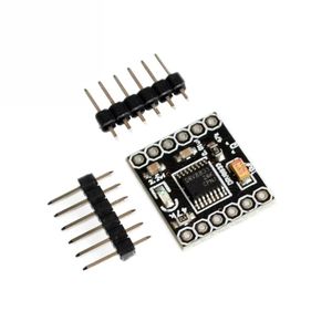

  • Dual h-bridge module(DRV8833)

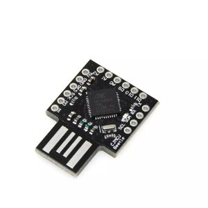

  • USB Atmega32u4 board

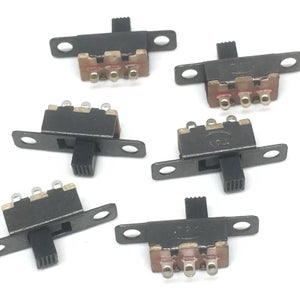

  • micro on-off switch

I use a small Arduino-compatible board based on Atmega32u4 MCU as a brain since it has native usb support, which means the MCU can communicate with the laptop without the need for an additional USB chip. This keeps its size small. Perfect for our project.

It is a bipolar stepper motor(4-wires)-consists of 2 coils inside, which is why we need 2(dual) H-bridges to drive a single stepper motor.
The resistance per coil can affect the current draw of the motor. Too much current can damage the motor by overheating the coils. The driver that I choose can't limit the current, so I power through a 3.3v regulator to lower the maximum current instead of using direct 5v from the usb. With Ohm's Law, we can calculate the maximum current- current(A)=voltage(V)/resistance(ohm), which in this case is about 0.2A(200mA).

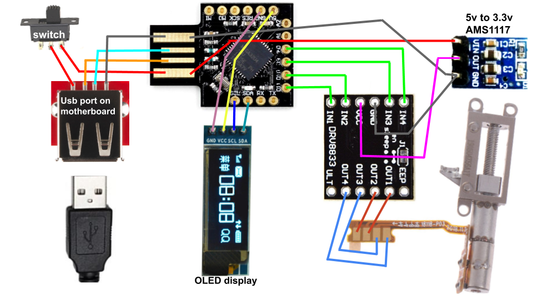

Step 5: Connections
You can pull the wires out from the hole drilled in the previous step, and connect it to the Arduino's usb.
You can connect everything according to the diagram above.
If any module is pre-soldered with header pins you should remove it beforehand.
I use wire-wrapping wire to connect everything, it works flawlessly for this project that has a lot of connections that are small and close together. I can even strip the wires using my nails. I have tried other bigger wires, it is a lot harder to solder.

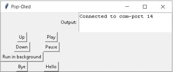

Step 9: Desktop Application
I write the code using python.
I use the Psutil library to get CPU performance data. And Pyserial library to communicate with the Arduino board via com port.
Tkinter library to create desktop UI.
I have made an EXE file for you to download and run it on your computer. (Tested on Window10-64bit)
In case .EXE is not working for you, you need to install python and the libraries manually.
Firstly, you will need to enter the com-port number to which the Arduino is connected to. (it's the same port as when you upload code in Arduino IDE). Then click "connect".
If you enter the com port number correctly, it should now show the live cpu percentage on the OLED, and the control menu should show up.
menu:
Up/Down --> slide up/down 1/6 of the full stroke length.
Play-->display the real-time cpu percentage.
Pause-->pause
Hello-->slide up 100%
Bye-->slide down 100%
