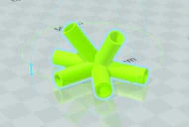

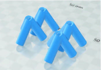

Step 2: Print Off the Connectors
In order to make the kite you will need connectors. You will need to print off 4 corner connectors and 30 six-way connectors.
Once the connectors are printed off, you need to make sure the dowels fit inside them. For the 6-way connectors included with this Instructable, the holes in the connector have already been designed wide enough to accommodate the 3/16th inch dowel rods used for the build. But even with these, there is sometimes a hole that gets printed too small or too large (at least, with the Monoprice 3D printer). When too small, I found I could use a butane torch to soften the plastic just enough to accommodate a dowel. Make sure you do not change the orientation of the hole when you soften it. Do not burn the PLA plastic! When too large, well, that is coming later.
Also, now that you are done printing off the connectors, it is time to insert the metal eyelets into the corner connectors: take a metal eyelet, hold it with a pliers, and hit it with the butane torch until quite hot, then gently screw it into the connector's point until it is well secured there. Cool it off with a spritz of water and test it: it should not come out. Be carefuk while heating and inserting these that you do not heat the whole connector so much that it becomes distorted. If you make a 3-sided pyramid with other connectors and some dowels with the corner connector at the top, you will be certain not to change anything important about it when you melt the eyelet into place.

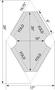

Step 3: Cut Out the Airfoils/ Sails
Once you have all the connectors ready to go, you can start the airfoils. You could also do these first: the order of operations does not matter.
The picture provided is exactly proportional to the airfoils required. The gray area represents the physical airfoil; the dotted lines represent the dimensions of a theoretical diamond shape from which the airfoil is made; the dashed lines represent fold lines.
If making a kite with 12" dowels, then the measurements given here for the airfoils must be cut and folded accurately in terms of angle of cut and of fold. Even small deviations might make the resulting airfoil impossible to mount without breaking dowels. Once the folds have been made, each of the four side flaps must be held down. They can be sewn, held with hot glue, or sealed using a heat sealer: tyvek makes a neat bond when treated with heat, but you must not heat it too long or it will liquify. I used my Food Saver to create these seams, for just over 5 seconds per seam. At 6 seconds the tyvek would melt and ruin the entire airfoil. At 4 seconds it would not make a secure bond. Timing this just right was tedious, but it beat sewing each of these seams in place.
Note that if you have a rotary cutting tool you can save a LOT of time by first folding all of your tyvek or other paper in half and then stacking all 16 folded sheets together before cutting. Tyvek is slippery, so if you use it and you decide to cut as a stack you need to be careful that none of the folded pieces slips out of position as you are cutting. Also note that you will not be able to accomplish this with a handheld scissors-- only a rotary cutter can cut stacks of materials this way and have them all come out the same.
Having said this, "all come out the same" is a perilous outcome because a single error means everything in the stack is affected. But a rotary cutter will make the production time for the airfoils into a fraction of what it would be otherwise. I highly recommend using one.
There are 16 airfoils in this kite. Creating them took over an hour. Sixteen is a lot.

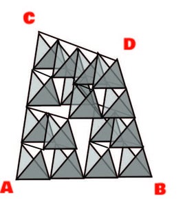

Step 4: Assemble Kite
There are no real tricks here. Imagine you are beginning at the lower left of the diagram (A). The airfoil here will require one 3-way corner connector at its left vertex (corner), and then a six-way connector at its right vertex and two more connectors at its top (one left, one right). Run the dowels through the seams of the airfoil and press the dowel tips into the connector. The result should look like a V. Make four of these V's in a row. This is the leading edge (A-B) of the kite.
As you insert the dowels into the ports, if the connection is too loose and you can turn the dowel easily in the port, you will want to secure the connection with a bit of hot glue by putting the hot glue on the tip of the dowel and then ramming it into the port while still molten. Do this after you have run the dowel through the seam of the airfoil, not before. Use no more glue than necessary, however, as this will make later disassembly very difficult.
Return to the left side of the kite and complete the next row, sliding dowels into airfoils and then pushing the tips into the connectors and using hot glue wherever called for, until you reach the top of the kite (C-D). As you go you will need to make sure you are orienting the connectors correctly. This is especially important if you are securing the dowels using hot glue, as fixing the problem may require you to turn a hair dryer onto the connector to loosen up the glue.
There's a thing about tetrahedral kites: because of the way they are structured, they are very difficult to make come apart: the airfoils naturally hold the dowels in place in the connectors with surprising firmness. Taking the kite apart is actually somewhat risky as you may find you need to tear an airfoil to get its dowels out.
Also, there is this: as you assemble the kite, you may discover that one or another of your airfoils wasn't folded quite correctly or was glued at an incorrect angle and that you cannot get its dowels to reach its corresponding connectors. This usually means the airfoil must be discarded and regenerated. I found that in some instances I was able to patch over the problem by creating paper "saddles" over the offending edge of the airfoil and running the dowel through these instead of the airfoil's original channel.
You may also find that one of your connectors "splits" as you are inserting a dowel tip into it. This may happen if the PLA was not laid down heavily enough during printing, but could result from any number of printing errors. These connectors will need to be discarded and replaced. This is one of several reasons why you should print several replacement connectors-- you will never know if a connector will split until you try to use it, and sometimes a connector that worked fine the first time you used it will come apart the second or third time. You need to have spares ready to go, because you can't very well fly the kite if it is missing even a single connector.
Once done, run some thick string through all four of the metal eyelets. When you tighten this string, it should pull the entire kite taught. Do not overtighten or you may break a dowel. The main purpose of this strng is to keep the kite from flying apart, not to compress it into place. There are six edges to the kite, each just over four feet long, so you will need at least 26' of string to do this.
Assembly is not fast, nor can it really be rushed.
