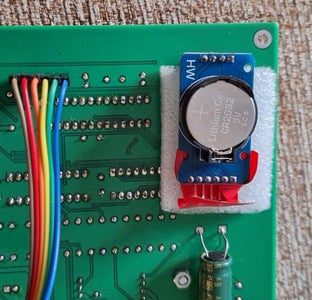

Step 2: Assemble the PCB
Fit the components to the PCB using the schematic as a guide. I would recommend using sockets for the IC's - especially the microcontroller. The PCB can either be bought from my Ebay store (link in supplies) or you can make your own.
*** Addendum to the schematic; the 330ohm resistors should, ideally be 390 ohms instead as this would bring the segment current of the hours and minutes displays to within 1mA of the seconds displays which is around 16mA. With 330ohm resistors there is about 3mA difference which could on some LED displays make the segments displays slightly dimmer than the rest. It wasn't noticeable on mine but I would use 390 ohm resistors instead. ***
For the RTC module check the battery you have fitted as these come with a LIR2032 (rechargeable) or CR2032 (non rechargeable) battery and the charging circuit is always active. It overcharges the lithium cell if LIR2032 fitted and will cause a CR2032 to explode eventually.
The RTC module is fitted to the back of the board with the battery facing outwards as shown.
It is important to either
  • A) disable the battery charging circuit and throw away the LIR2032 and replace it with a CR2032
  • B) replace the battery with a supercapacitor.
To disable the battery charging circuit remove either the diode or resistor as shown in this guide Modifying the RTC module - Camper Control
