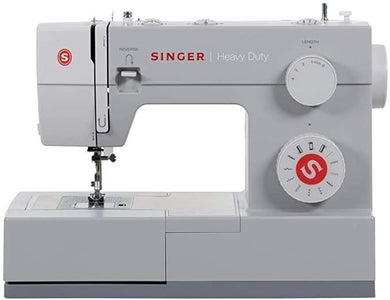

Sewing machine

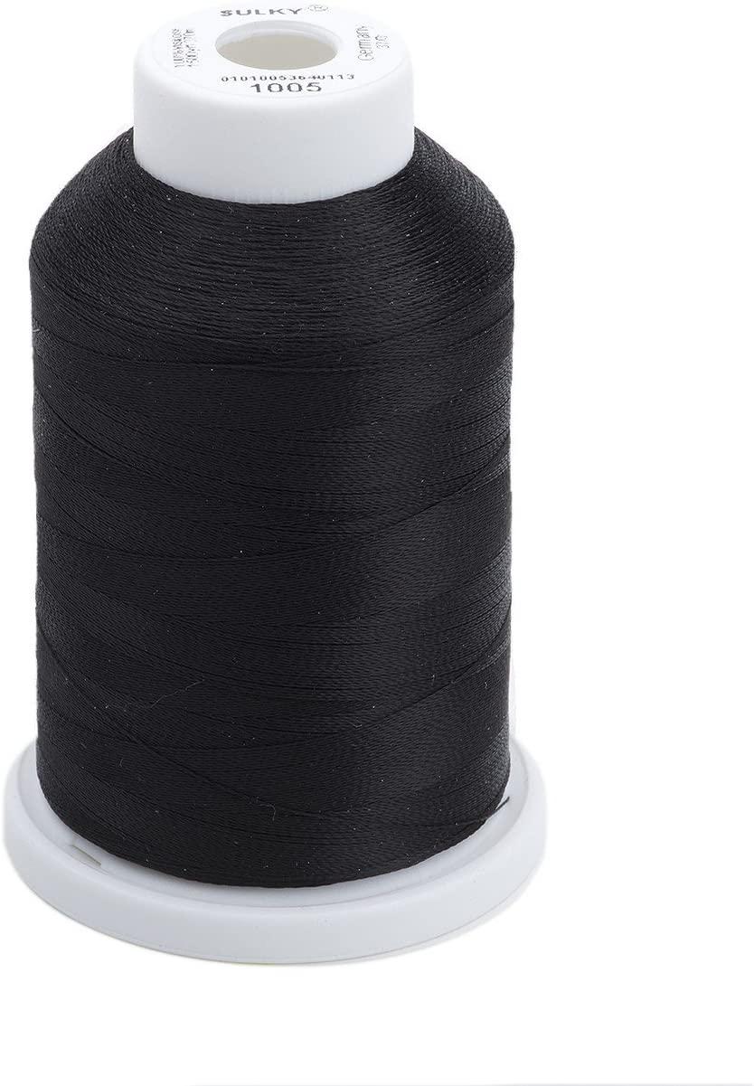

Sturdy thread in matching color

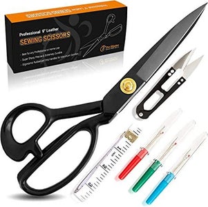

Scissors

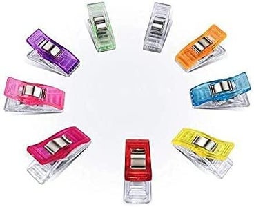

Clamps
Measuring tape

When cutting the leather, do not use pins, as they will leave permanent holes in the leather. Instead, use little metal fabric clamps. They are available at some dollar stores and at most craft and fabric stores.

Now you're ready to sew. Insert a leather sewing machine needle in your sewing machine, and thread the machine with sturdy new thread (I like Sulky) that matches the color of your tote. Adjust the tension as needed and be prepared to sew a bit more slowly than usual. Sew the side seams and the bottom seam of the tote. Again, use the metal clamps to hold your seams together while sewing, instead of pins, to avoid disfiguring your leather with pinholes.
