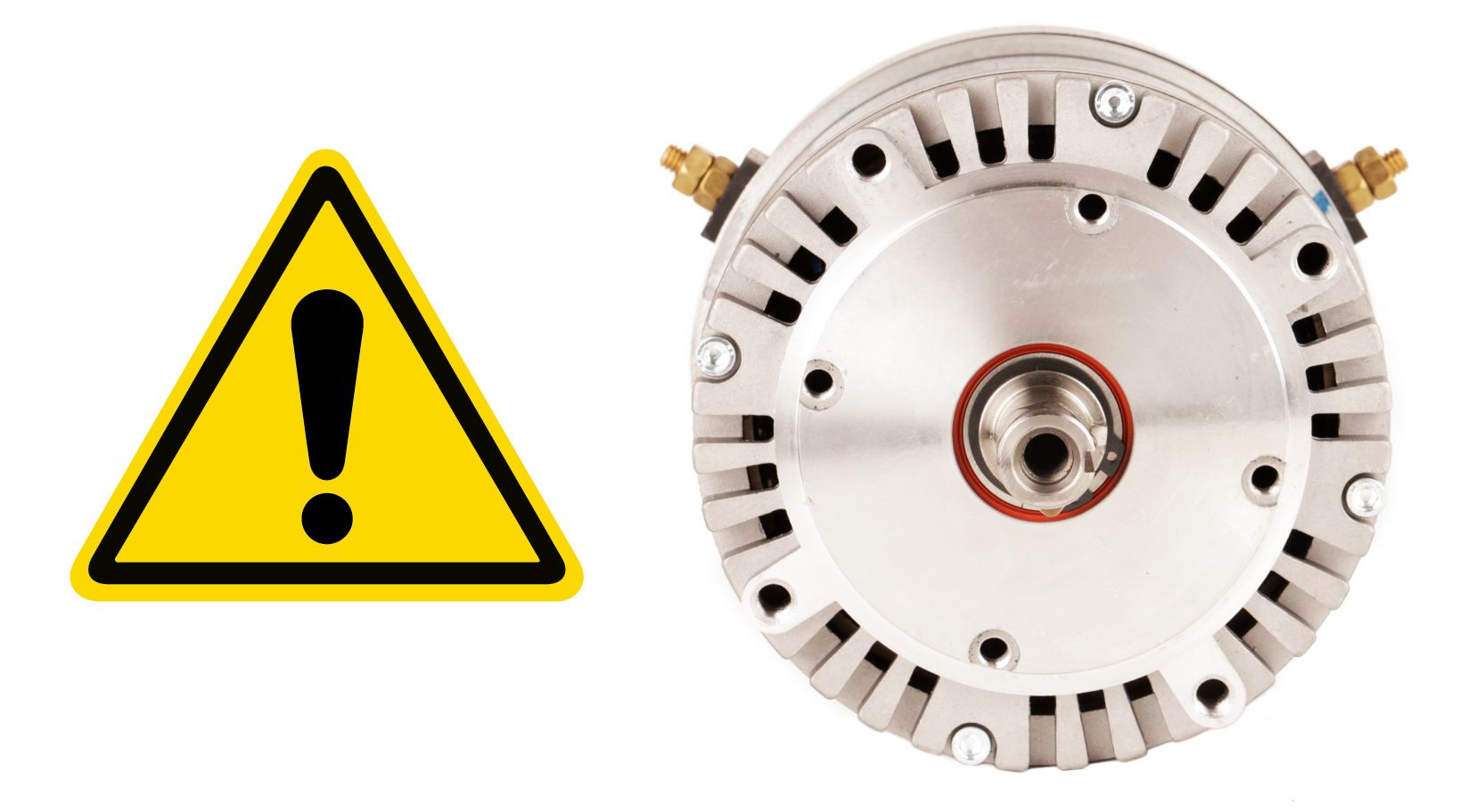

Introduction: Large Motors
In this class we will be covering how to control large electric motors. For the sake of a definition, a large motor is a motor that requires 12 or more volts to operate and requires 5 or more amps. The motors we will be using in this class are suitable for building things such as scooters, go-karts, electric motorbikes, very large robots, or even, potentially, small electric cars. If you want to move something big or heavy, chances are you need to use a large motor.

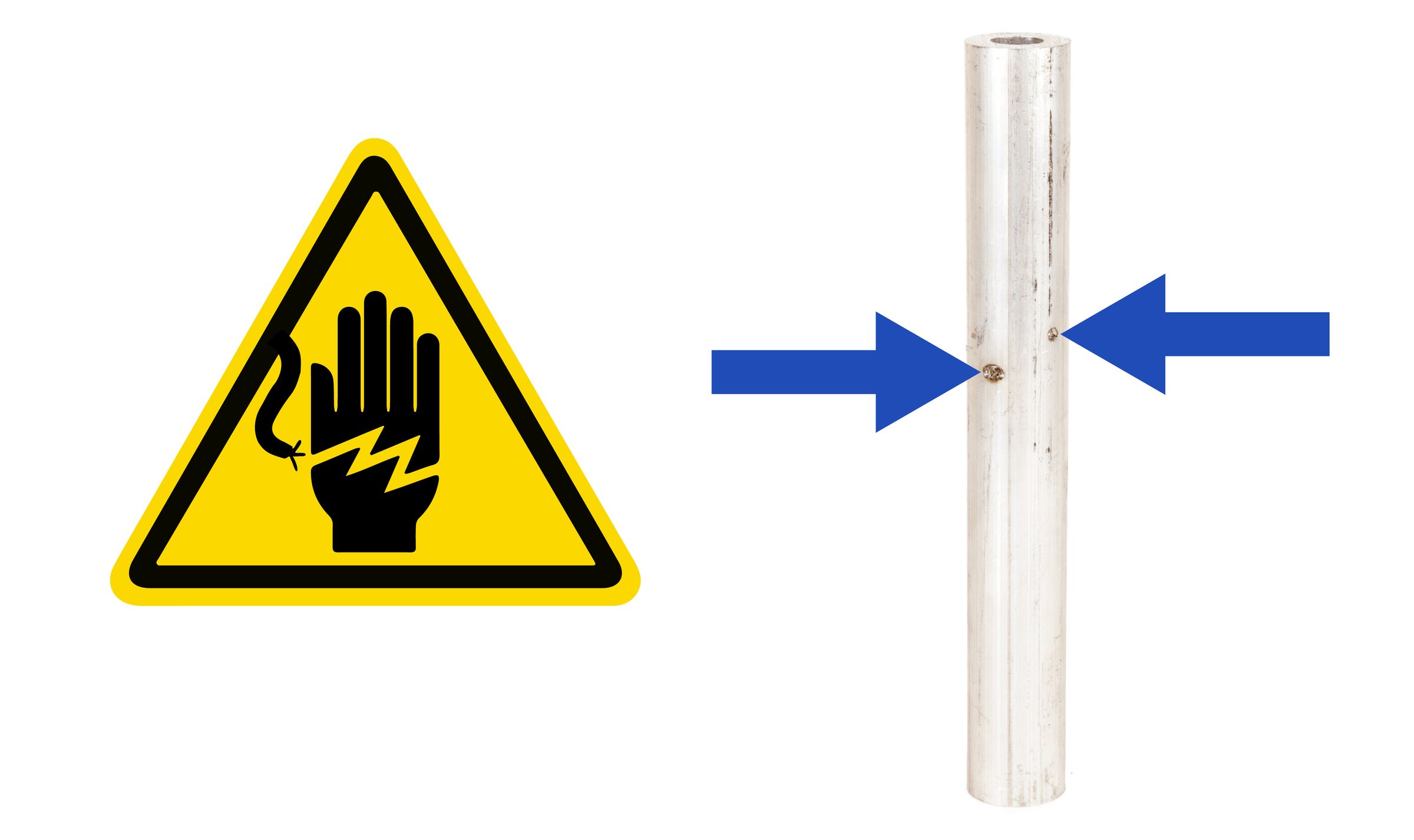

Also, the size of the batteries required to power large motors packs a lot of electrical energy. These batteries probably won't electrocute you quite in the same way sticking a fork in a wall socket would, but they should always be handled very carefully and with best practices. In other words, you never want to put yourself in a situation in which your body can potentially become a pathway between voltage and ground in the circuit.
Albeit electric shock is probably unlikely, receiving a nasty burn is very real. When a 24V battery bank accidentally shorted across the aluminum bar pictured above, it got so hot that it melted (at a temperature above 1,221°F). That is not even to mention that it was shooting flaming hot electrical sparks everywhere, which makes most everyone more likely to freeze, panic, or do something incorrectly. In short (pun intended), crossing electrical connections when dealing with this amount of current can cause fires or severe burns, so be careful of all of your electrical connections!

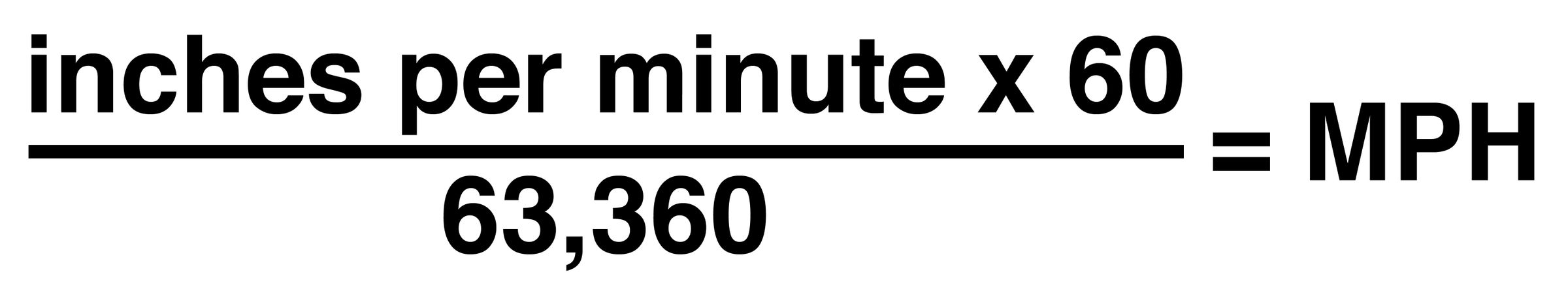

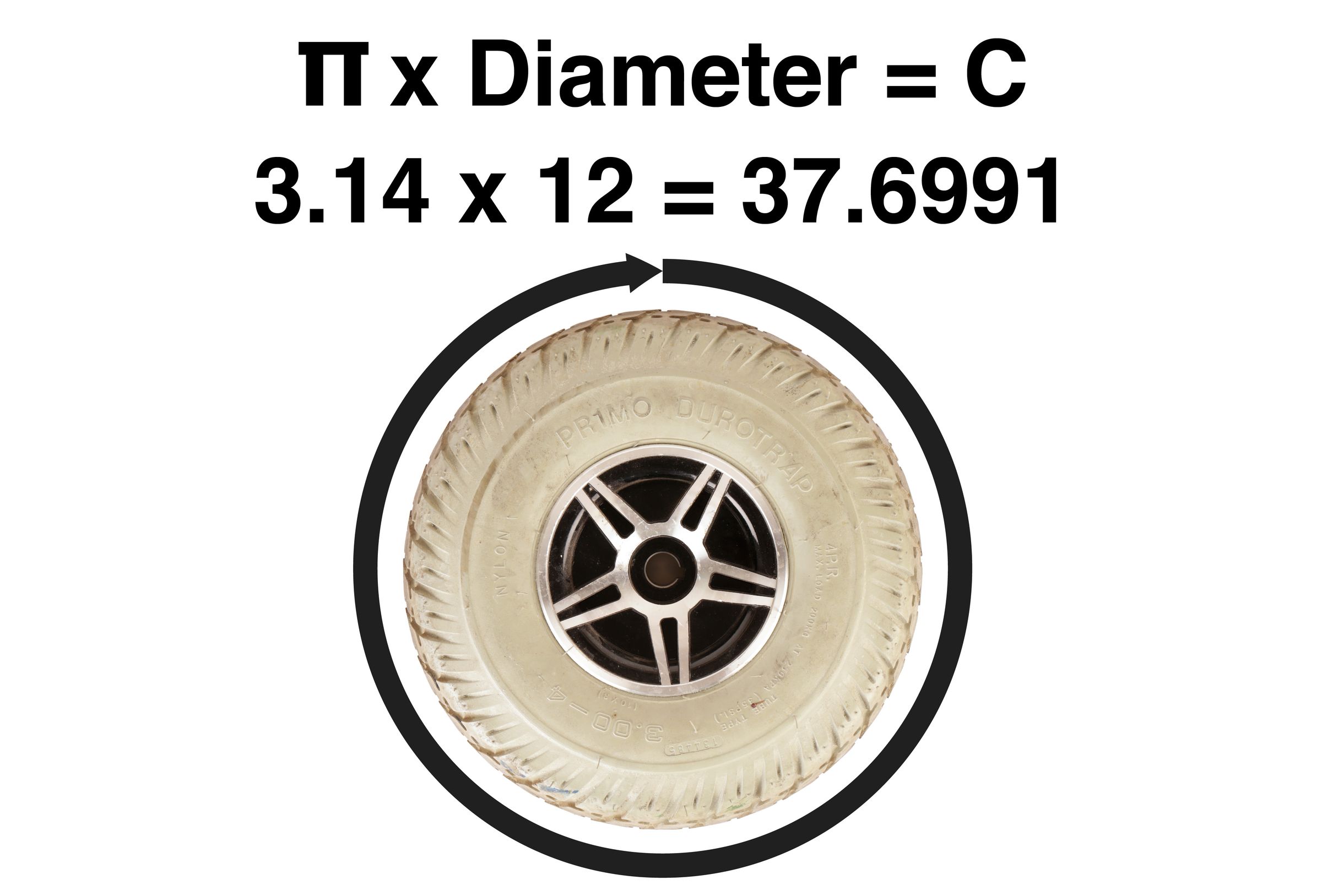

Let's say we want to measure the speed of the entire mechanical system in terms of the distance it will travel over a period time. In other words, let's say we are building a go kart and want to get a measurement in miles per hour (MPH). To figure out what the actual theoretical top speed of the system we are building, it is important to understand the diameter of the drive wheels attached to the motor's shaft (or the output shaft of a geared system). Let us imagine that we are trying to figure out how fast our ME0909 motor would be driving a go-kart with a 12" wheel at the speed of 2,000 RPM.
First thing, you would need to calculate the 12" wheel's circumference. Using the above formula, we can calculate that it has a circumference of 37.6991 inches. What this means is that every time the wheel does a full rotation, it will theoretically move 37.6991 inches along the ground.
Now that we know the distance traveled per rotation, we need to multiply this distance out by its speed (2,000 RPM). To do this we simply multiply 2,000 with 37.6991. The value we get is 75,398.2 inches per minute. Of course, inches per minute is not exactly a useful unit of measurement.
What we really want to know is how many miles per hour our motor is going to go. To do this, first we need to multiply 75,398.2 inches per minute by 60 because there are 60 minutes in an hour. This gives us a value of 4,523,892 inches per hour. However, that number is ridiculous and inches is still not a useful a measurement at this scale. We need to convert this to miles by dividing the total value by 63,360 (the number of inches in a mile). This gives us a total top speed of approximately 71.4 MPH.
