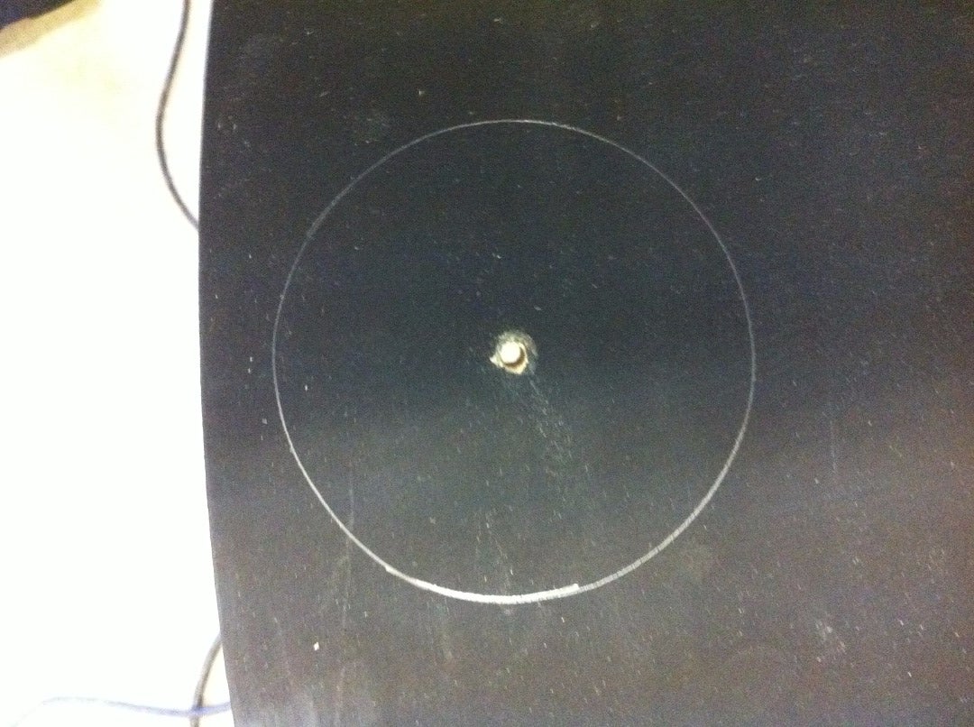

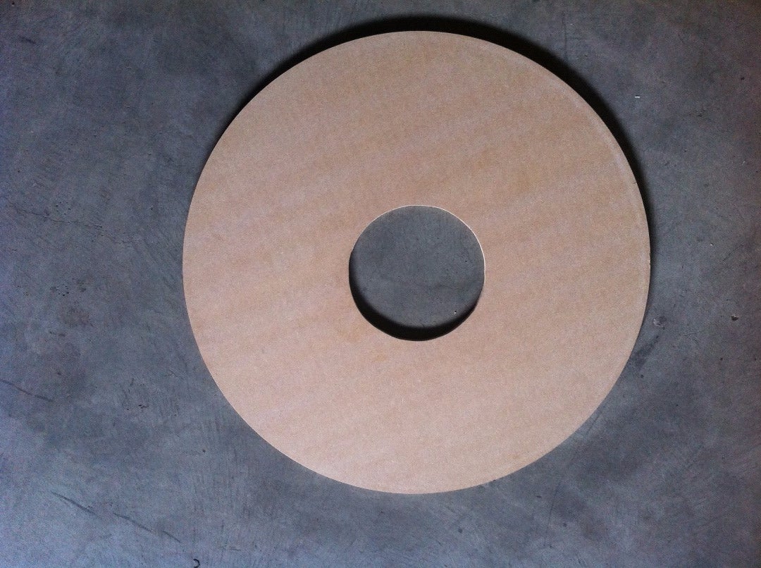

Step 2: Step 1: Cut MDF Board & Paint
First thing I did was mark my MDF board up with a 3.5 ft by 3.5 ft circle with a 1 ft by 1 ft inner circle. Once this was marked up I used a jigsaw to cut the outer and inner circles out.

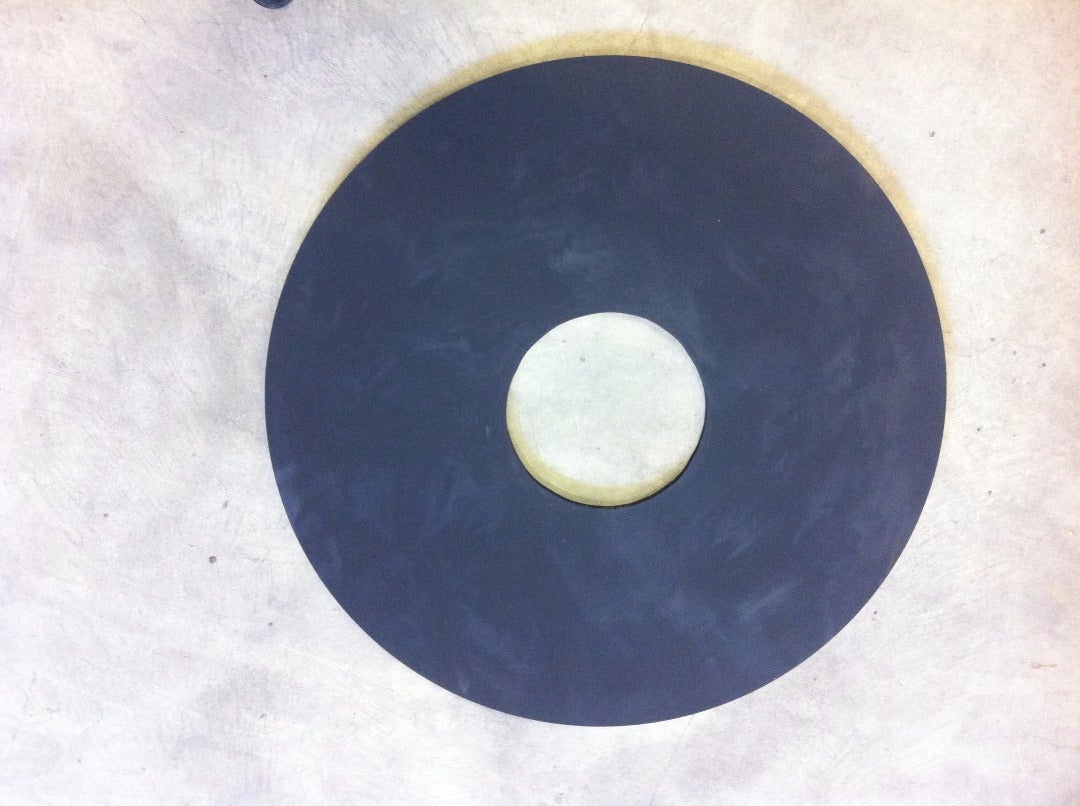

Next I painted the circle black as this will help absorb any excess light from the bulbs.

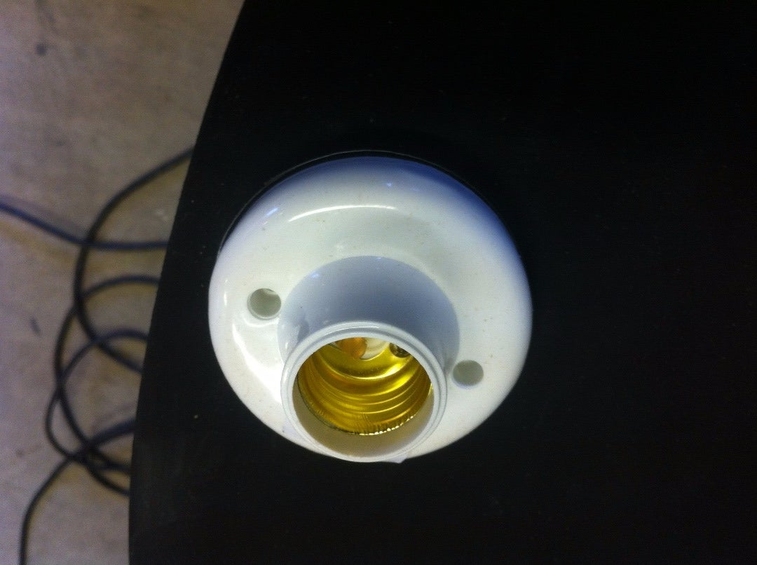

Step 3: Step 2: Make Up Bulb Holders and Drill
Placing the bulb holders on the board in the positions you want them to be on the finished ring light make around them with pencil.
I placed my outer ring on the hour positions like a clock and the inner ring I spread evenly between.
Next drill a hole in the centre of each circle you've drawn on your ring light as this will be where you thread your wires through. Make them large enough to fit two sets of wire through.

Anyway with that safety bit out the way wire each socket holder up. I did mine in parallel with the outer and inner rings on separate runs. Make sure you don't mix up the polarities as it can be a nightmare going over each socket holder one by one checking which one is wired wrong.
Take your time and you shouldn't have any issues.
Once they're all wired together you will have two sets of positive and negative wires (if done like mine in two runs, one if done all in one run). Wire these to the plug and put to one side.
Screw down the socket holders onto the MDF and secure any loose cable behind the board (so it doesn't look as messy as mine did).
