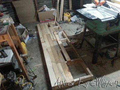

The measurements of my desk are 2400mm x 700mm. You can do whatever dimensions you like as my instructable shows the process no matter what dimensions.
The height of the desk is 750mm to the top, or 640mm from floor to frame to allow for leg clearance.
I drew up a diagram to show how all the parts go together. I use some photos and text in this instructable, but I highly recommend watching the videos for detailed 'how to'.

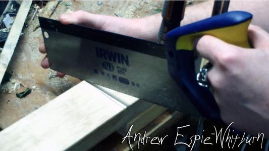

I use a hand saw, clamp, square and wood knife to cut the wood.
I mark on the wood where I want to cut, use the square to rule a line across, then use the wood knife and square to score the wood fibres. Take care with the knife, and go slowly with scoring the wood. It is best to make multiple shallow passes than one big one to score the wood.
The reason we score the wood is so the hand saw will be guided somewhat by the score lines. You could use a mitre box too on this step, but I am hard core and just went free style.
Once the wood is scored, clamp wood to bench. Make sure to place a piece of wood under the wood you want to cut so you don't cut your bench below (if that matters to you)
Next, slowly draw the saw across the score lines and begin to cut.

The main parts of the frame are 90 x 35mm Timber. I make 4 of these frames, then I attach 2 together using 42 x 19mm timber.
