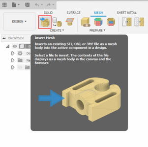

Step 2: Import the STL Mesh
In the MESH workspace, go to CREATE menu and choose the Insert Mesh function. You can do the same with the INSERT menu and Insert Mesh function.
