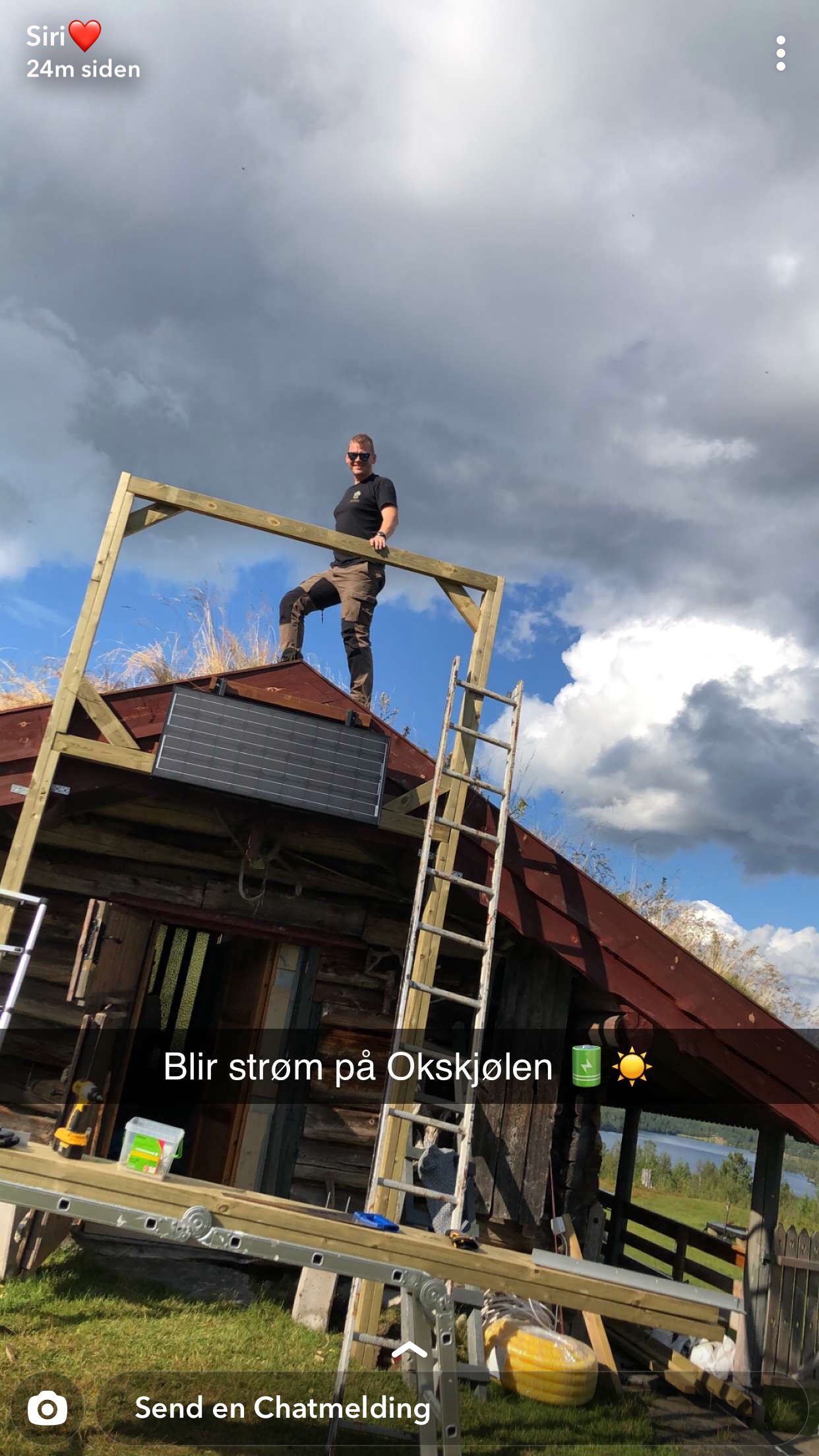

This instructable documents my build of a solar panel wall mount with tilt.
I built the mount with 2x4s pluss a tiltable frame in 1.5"x3" wood. The scaffolding stands about 5 meters tall and the frame supports 4 PV solar-panels measuring approx. 100x165cm each.
The scaffolding us built with overlapping 2x4s to ensure strength in the structure.
The titable frame is attached to the scaffolding with hinges on top and measures 405x175cm.
16 x 3.60m 2x4
8 x 4m 1.5"x3"
6 x Hinges
Box of screws
Ground support (concrete in my case)
(4 x solar panels measuring 95x165cm)
Small brackets for the solar panels
Step 1: Tiltable Frame
This is the most important part where the frame is designed to fit 4 x PV (solar) panels measuring 95x165cm each.
The frame tilts with a support bearing that attaches to the scaffolding (not shown).
Although this step is the key in the build, It has to be custom-designed to your house/wall. Make sure you build it strong enough to carry the weight of your panels (mine add up to about 72kgs).
The old 80W panel is still on the wall. Going from 80W to 1.2kW is the plan

Step 3: Backside Inspection and Field Modifications
I had to modify the frame of the last panel to make it fit into my frame due to a miscalculation. The brackets attached to the frame add an extra 2cm each on the side, for a total of 10-12cm.
No issues if you carefully drill a hole in the aluminium frame of the panel.
Step 4: Finished!
That's it. Done in a day given your mileage.
