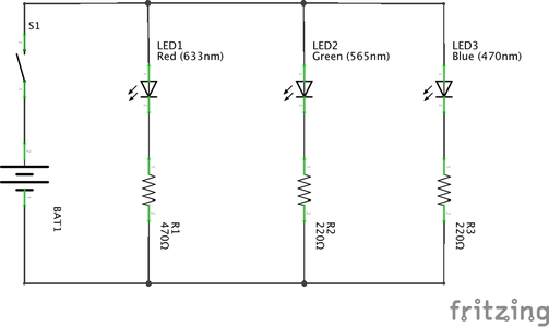

- 3 resistors (2x 220 Ohm, 1x 470 Ohm)

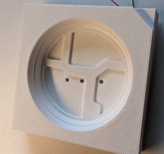

All STL files for 3D printing can be downloaded from the project page at printables.com. The parts shown here were printed with a 0.6mm nozzle to speed up the print, but all nozzle sizes will work.
To avoid support, you can use the shown part orientation on the build plate.

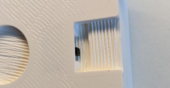

When printing without support, check the bridging areas and if necessary, modify the bridging angle to minimize the length of the bridges. For the top part, the bridges are inside and not visible after assembly. On the bottom part, they are hidden by the pads after assembly.
Step 2: Inserting the LEDs

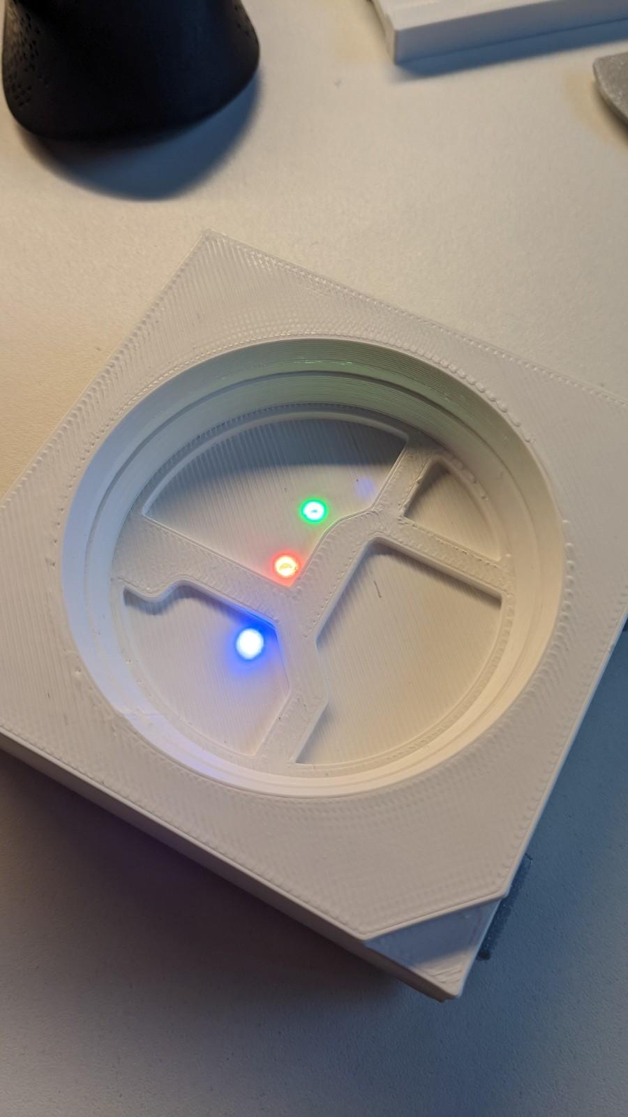

The three 3mm LEDs are inserted into the 3 holes of the top part. Color order is shown in the picture. If the holes are too tight after printing, use a 3mm drill to ensure a perfect fit.

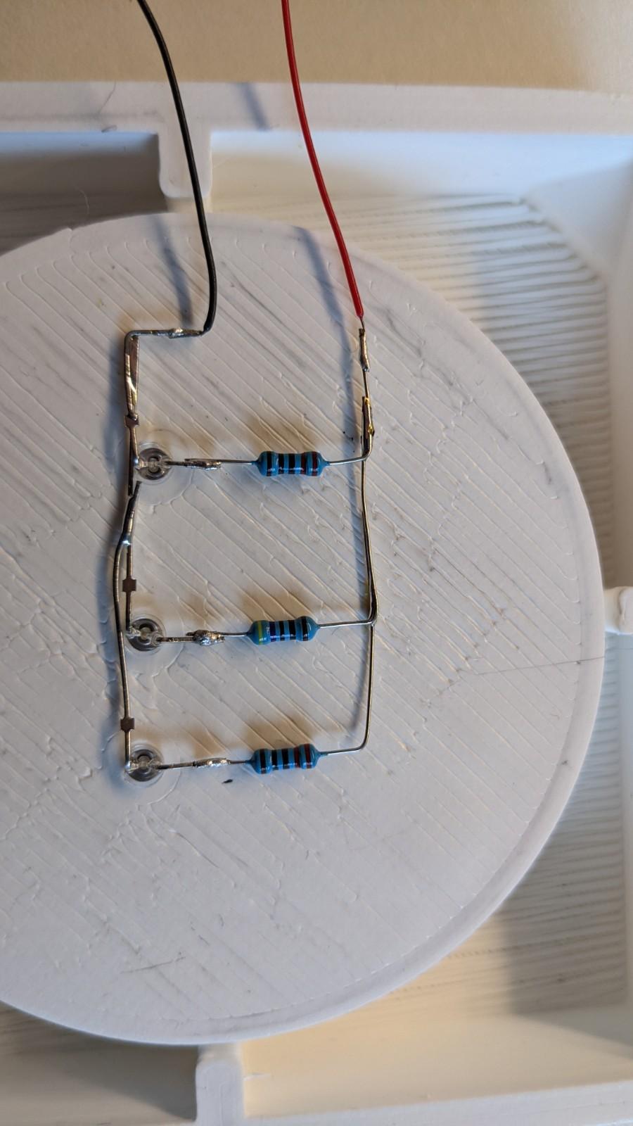

Insert the three LEDs from the back into the holes, all in the same orientation (cathode, the shorter leg, at the same side). By bending the wires, the LEDs can easily be connected and soldered together like shown in the pictures.
By using sider cutters, the wires can be trimmed to have enough space for the resistors. Depending on the used LEDs, the resistors mighty be changed to get an even brightness for all three LEDs.
After successful testing of the circuit, the wires and components can be fastened to the 3D print with hot glue.

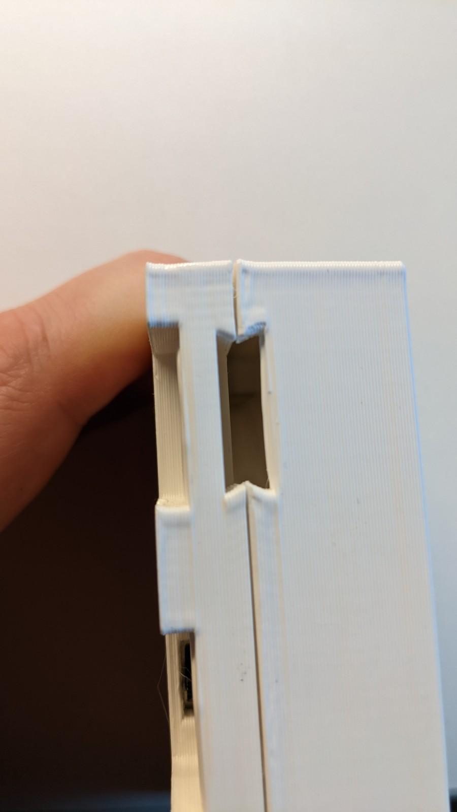

Top and bottom part are held together just by sliding in the 4 pads from the side.

That's it, the 10001000 LED is ready for use. Put your beverage on top, switch the LEDs on and enjoy the light.
