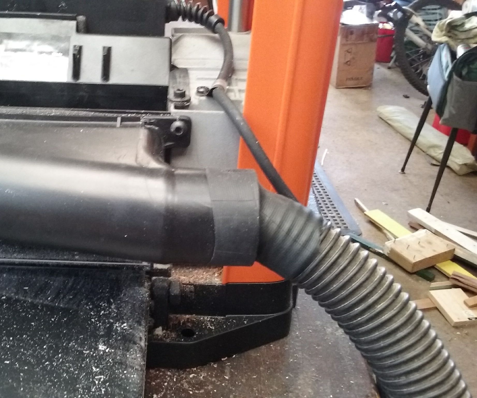

Step 7: Making the Drawers
I widened the filing drawers using a biscuit join then cut all the wood for my drawers to length before I thicknessed them down from 19mm thick to 12mm. This was a slow process and it was really important to only thickness one side of each piece so as to not jam the thicknesser. Once thicknessed I set up a the dovetail jig and cut through pin dovetails on all the front corners of the drawers. I then used the touter table to cut a through housing in the back of the drawers before cutting the slot for the base on the table saw.
8. Buy Materials the Right Size
I was only able to buy the timber I was using in 19mm thick boards, this made thicknessing the wood down to size an incredibly slow process. It consumed vast amounts of time especially as Jarrah is a very hard wood. So if you can, buy your materials close to the right size it will save you time and money as you wont be paying for waste materials or new tools and blades to mill it to size.
