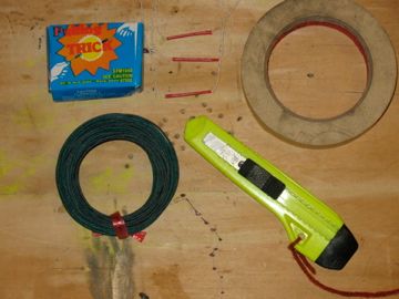

The time-delay fuse used in aerial shell is known as 1/4" Time Fuse or Oriental Time Fuse. It is available in coils of different lengths and has a nominal outer diameter of 1/4" (although occasionally you will see other diameters for sale, stick with the 1/4") . All 4", 6" & 8" shells use the same length of fuse, 1.25" (1-1/4").
It is important that time fuse is cut with a blade and not a scissor-type device. The powder core is somewhat fragile and if cut with a scissors or similar device the end is crushed (to varying degrees) and the powder loosened from its packed state, increasing its burn rate.
Insert a 1.25" long fuse into the bottom half of the shell, leaving about half the length sticking out the bottom of the shell.
Using a Hot Melt Glue Gun, lay an even bead of glue around the base of the fuse sealing it to the casing. When cool, do the same on the inside of the shell. It is important that there be no gaps in the glue which could allow fire to enter the shell during launch.
