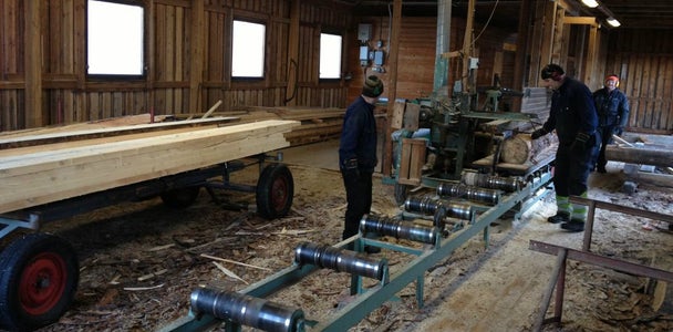

I like to do things from scratch so I went out and got some logs in our forest and took them to the local sawmill.
