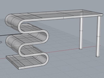

Step 1: Commit to an Unreasonable Design
You should've seen what design I showed Coby before this one! The ridiculousness of the former design is likely the only reason Coby was willing to entertain this one.
Structural integrity was a major concern for this design. I figured I could remove more of the straight bits between the wiggle to improve stiffness and more directly channel load, or even drive a support leg through the whole thing if things really went south.
As the project progressed, I decided that instead of legs on the non-curvy side that I would just mount the desk to the wall to create an illusion of cantilever.

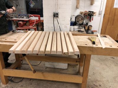

Step 3: Make 2 Giant Wood Tubes
The idea for how to build the curves came from Coby who had previously build a gorgeous cylindrical box using a similar method. These tubes may have been the largest thing every put on the Hobby Shop lathe. So far lots of folks have asked how the curved parts of the desk are made so I'll go into a bit more detail here.
- Cut out trapezoids to build polygonal tubes (how many sides of the polygon determines the angle)
- Get ready to glue by laying down LOTS of strips of blue painters tape underneath the slats to prevent swearing while trying to roll the slats into a tube (as you might guess, Step 2 was insufficiently followed for the first tube -- lessons learned!)
- Add glue to the sides of slats together to make two half cylinders so that we don't have to cut them later.
- Roll, mallet / push until flush on the ends, and spring clamp!

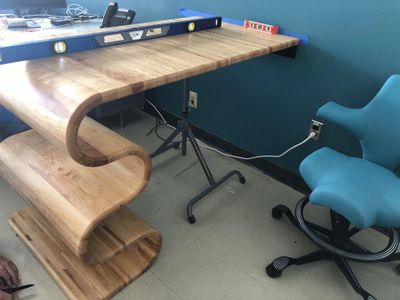

Step 10: Installation!
Matt McGlashing was generously willing to install this project in my office in building 36 at MIT. He was helped out by his dad Jack McGlashing. Super cool and extra special fact -- Jack helped install another project of mine The Cosmic Ray Chandeliers back in 2011 when I was an undergrad at MIT.
The desk is attached to the wall using a black anodized aluminum L 3" wide and cut to be 28" long. The L is screwed into two studs. The table top has 5 small screws connecting it underneath to the L. Matt used some discretely placed wood wedges to get the whole thing level. What a beautiful install job! It's so level and solid!
