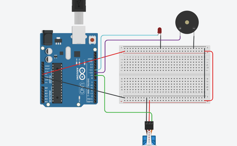

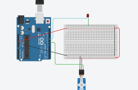

Step 3: Begin Your Wiring

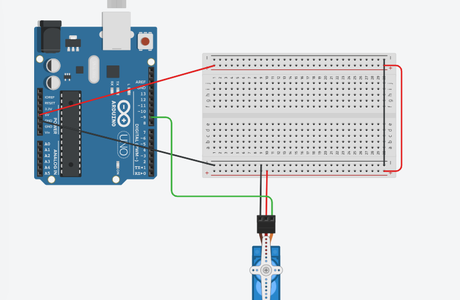

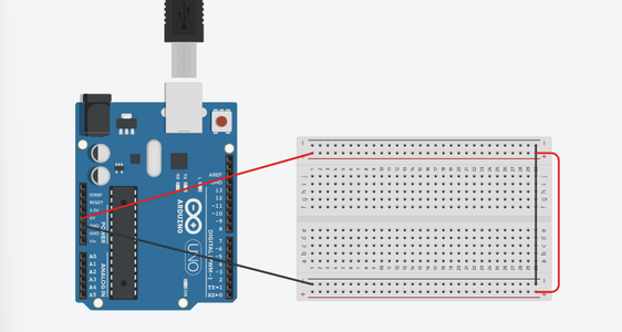

Step 1: Connect your power and ground from your Arduino to your breadboard

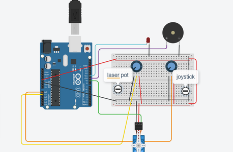

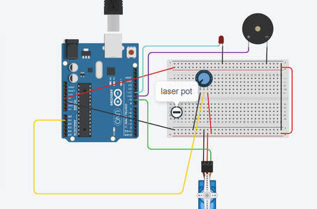

Step 4: Connect the Signal Pin of Your Servo to Pin 9
Step 5: Connect the Power Pin of Your Laser Diode to Pin 11
Step 6: Connect the Your Buzzer to Pin 10
This will add some cool audio to your laser
Step 7: Connect Your Potentiometer to Pin A1
This will control your laser
Step 8: Final Step on the Wiring
Take your long tether and connect it to the pins of your joystick power to power, ground to ground
you will attach the "X" pin of your joystick to pin A0

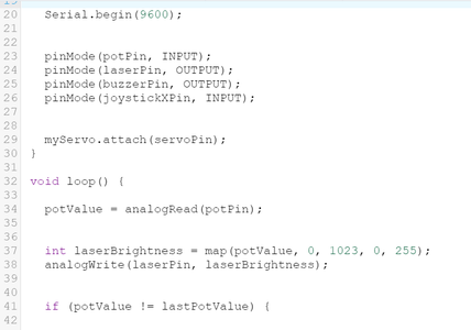

void setup() {
 Serial.begin(9600);
 pinMode(potPin, INPUT);
 pinMode(laserPin, OUTPUT);
 pinMode(buzzerPin, OUTPUT);
 pinMode(joystickXPin, INPUT);
 myServo.attach(servoPin);

void loop() {
 potValue = analogRead(potPin);
- **Reads the analog value** from the potentiometer and stores it in `potValue`.
 int laserBrightness = map(potValue, 0, 1023, 0, 255);
 analogWrite(laserPin, laserBrightness);
- **Maps the potentiometer value** (0-1023) to a brightness level (0-255) for the laser.
- **Sets the laser brightness** using `analogWrite` on `laserPin`.

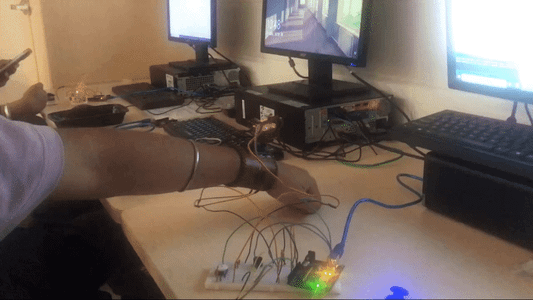

Step 11: Enjoy
If all goes well, you will have built a working Arduino laser cannon
