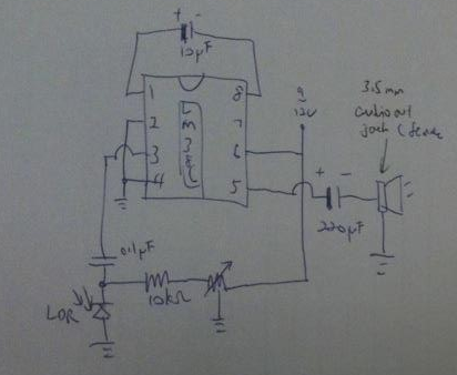

Receiver:
The receiver essentially works the opposite way, with the laser replaced by an audio-out jack and audio-in jack replaced by the light dependent resistor(LDR). The LDR will vary the amount of current (via resistance) depending on the intensity of the light it receives. The current will be input into the LM386 which amplifies the electrical current and converts it back into audio.

Receiver:
