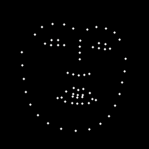

Step 3: Dlib Landmarks
Dlib's facial landmark detector provides 68 (x, y)-coordinates. In this project, left or right eye blinking controls the panning servo's left or right movement, while opening the mouth activates the laser. Closing the mouth deactivates the laser. The mouth is accessed using points 48 to 68, the right eye with points from 36 to 42, and the left eye with points from 42 to 48.
Having said that, I only use 4 points each from the mouth and both eyes, as shown above. The closing or opening status of the eyes and mouth is detected through the calculation of their respective aspect ratios. The aspect ratio is defined as shown in the picture above.
