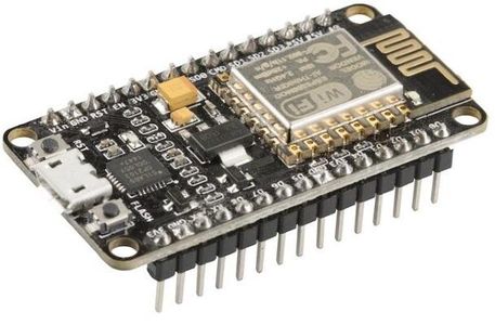

This project uses two servos, a NodeMCU, and a 9V battery to control a laser that moves around in a random pattern, keeping your cat entertained for hours.
The laser is mounted onto a 3D-printed arm and housing, making the setup sturdy and visually appealing.
There are only a few things you will require:
  • NodeMCU - Or a similar Arduino module

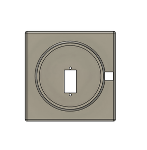

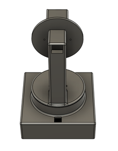

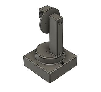

Step 1: 3D Printing
I designed the housing in Fusion 360 and printed them using white PLA.
The design consists of four main parts.
  • Base.stl - This is where the electronic components will be stored
  • Arm Bracket.stl - This allows the Z rotation.
  • Laser Holder.stl - This holds the laser and allows the X rotation.
  • Base Cover.stl - This covers the bottom of the base and protects the electronics.
I used the following print settings:
  • Infil: 20%
  • Layer height: 0.28mm
  • Supports: Yes (Specifically: Tree Supports)

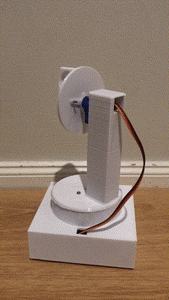

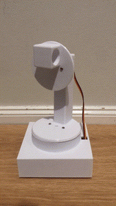

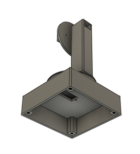

Step 2: Assembly
There are only a few steps required to assemble the entire cat toy.
  • First, mount one of the servos into the Arm Bracket and secure it using M2 screws.
  • Then, using two M2 Screws and Nuts, secure the other servo to the Base by slotting it into the allocated slot. (Make sure that the gear of the servo motor is in the centre)
  • Afterwards, secure the Laser Holder to the servo arm of the Arm Bracket by using M2 Screws.
  • Do the same thing by screwing the Arm Bracket into the servo arm of the Base.
  • Finally, thread the Servo cable from the Arm Bracket through the hole in the Base.
Now you should be complete with the assembly!
If you are confused, please look at the images above for some clarification!
Step 3: Wiring
The wiring of the Cat Laser Toy is simple, you can either follow the Fritzing diagram above or read the wiring diagram below.
9V Battery - NodeMCU
  • Positive (+) - VIN
  • Negative (-) - GND
X-Axis Servo Motor - NodeMCU
  • Positive (+) - 3.3V
  • Signal -D6
Z-Axis Servo Motor - NodeMCU
  • Signal -D5

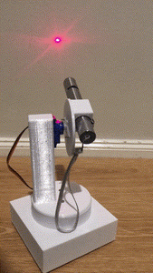

Step 5: Final Assembly
Finally, slot the laser toy into the Laser Holder and secure it in place.
Then, using four M4*8 screws, secure the Base Cover onto the bottom of the Cat Laser Toy in order to cover up all the electronics.
