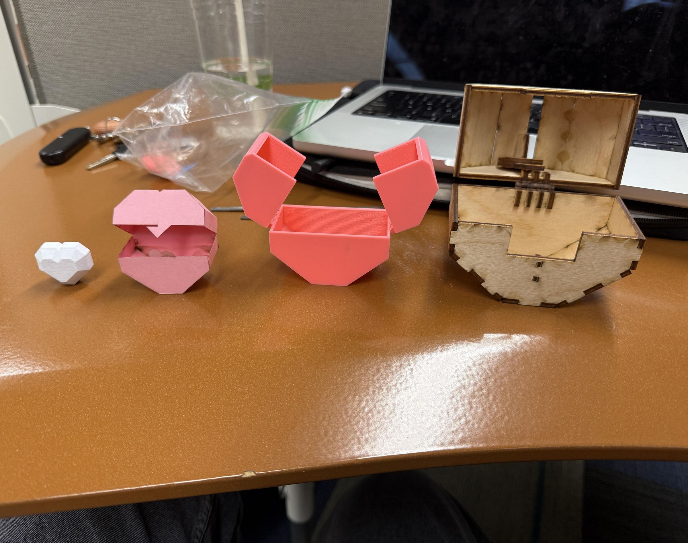

For this assignment, we were tasked with designing and manufacturing at least a 3-part laser-cut press-fit assembly. I decided to stay on theme and try to make the same shape as my last project, just with a different method.
  1. Plywood (we used 1/8 in thickness)
  2. Laser cutter
  3. Fusion 360
Step 1: Ideation

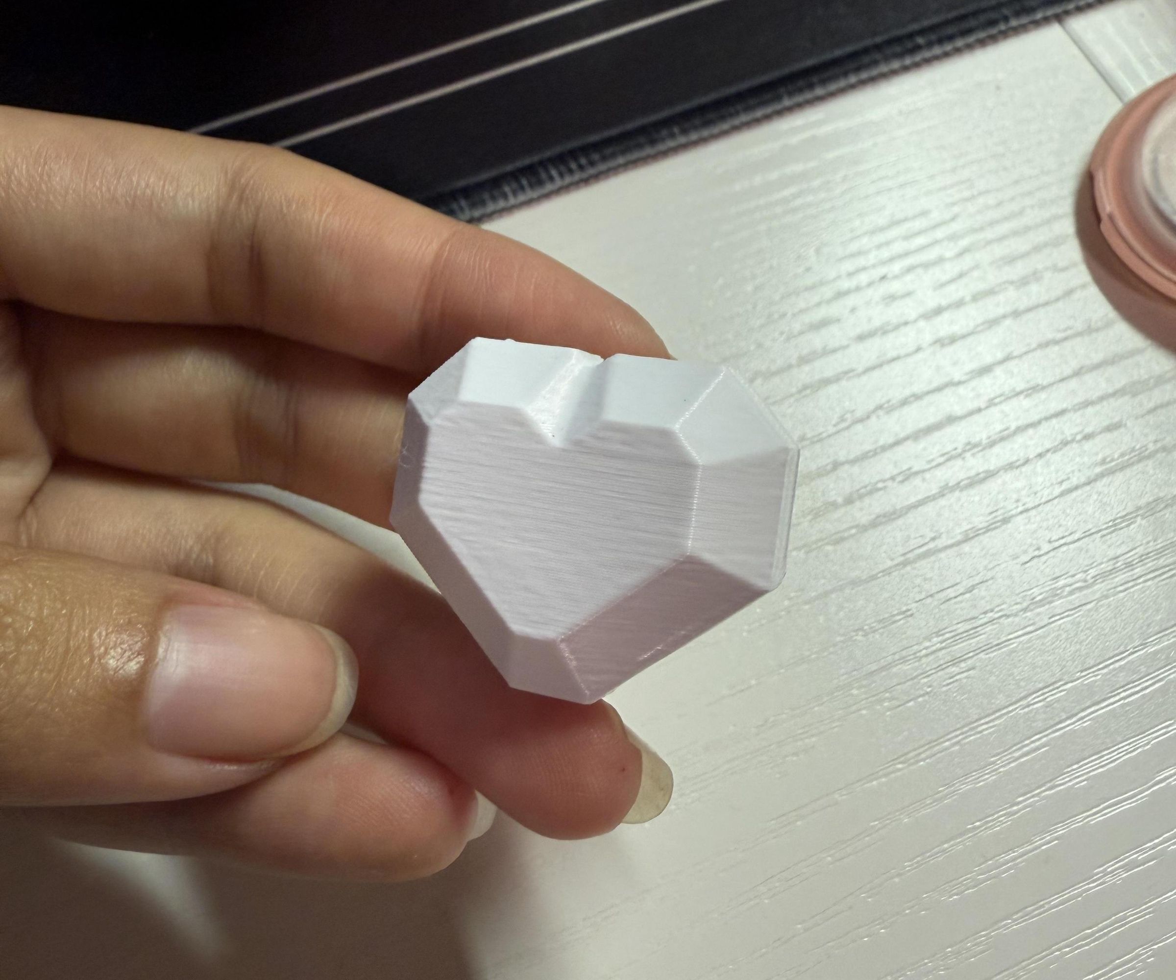

The idea was to design something akin to the 3D heart shown above, but broken down into more of a skeleton so that it could be press-fit together and potentially wrapped to resemble the 3D version.
Step 2: Digital Design
I chose to use a combination of half lap (on the sides) and finger (in the middle) joints to press-fit the pieces together. When deciding on measurements, I created the initial base first, then based the measurements of the other pieces on the aforementioned model by overlaying an image of a sliced 3D heart and tracing it.
Step 3: Fabrication
The parts were then sent to a laser cutter to be manufactured in the makerspace.
Step 4: Assembly
Even after setting the kerf setting in Fusion, some of the pieces were a little tight, so I had to hammer the pieces together a little. Additionally, after fitting the pieces together, I realized that there was still space between the pieces, which meant something was wrong, and turns out some measurements were off. So I had to go back and fix the measurements and print a second iteration.
Step 5: Final Product
The finished model came out very clean, and I was pretty satisfied with it. Some pieces in the second iteration came out better fitting than the first one, but I still had to hammer some of them. I think if I had some more time, I would've liked to mess with the kerf settings a little more to make it even better fitting so that I wouldn't need to use the hammer at all. Plus maybe trying to wrap the entire model to see if it successfully makes a nice 3D form to possibly be used as a decoration.
