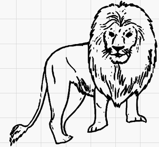

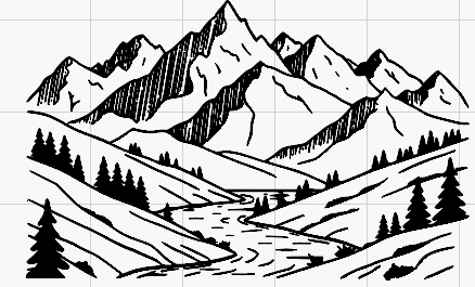

Find a simple vector image or a bitmap image created from a vector image. Look for images with clearly separated depth layers. Ultimately, laser cutters can only produce very limited shades of colour. Images should be chosen such that the critical features are not ruined by this limitation but rather accentuated by it. Thin lines may create problems, and gradients will likely be omitted during the trace.
Some suitable examples are attached. Originals found here:
  1. Mountains
  2. Lion
  3. Instructables robot

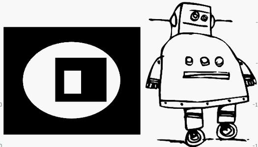

Lightburn has a very effective, highly recommended built-in trace functionality. An image of the trace tool in action is attached. The tool assumes you have a desired image of a single colour caught between a lighter and a darker colour. It attempts to place line loops on the thresholds between the three colours. "Threshold" sets the border on the lighter colour and "cut-off" the border on the darker colour. These can be adjusted to capture the colour borders you deem most important. Note that the operation can be repeated and the loops aligned and combined if you wish to capture more than three colours.
Now that you have a traced image, you could cut the outline and engrave it on a single layer of MDF as is normally done (see image) and get a good result. However, laser cutters give access to the 3d world (especially if not afraid to eat through MDF sheets). I believe leveraging this allows for much more artistically impressive works.

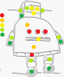

For this robot, I view it as having a chubby frame with a small head, arms and legs and thin hands and wheels. The knobs on the body stand up while the slot is sunken in. The strip at the bottom is riveted over the body. For stability, the whole setup should be mounted to a base.
To manufacture the model, the above should be translated into which features are exposed on what layer of MDF. For the robot:
  1. Hands and wheels are on the central layer. The head side panel is also exposed here
  2. The arms and legs are on the next layer to add thickness and a clear step height difference. Also, add the ears and face layer here.
  3. The next layer is the eyes and the slot.

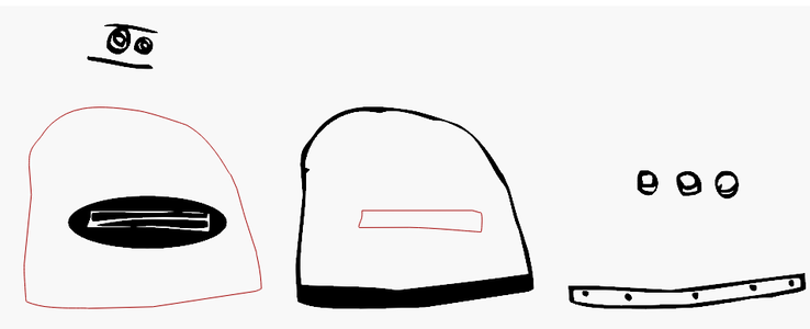

  4. Next is the body.
  5. Finally, the Buttons and the lower strip are added.
A colour-coded image is attached to clarify the feature split. This totals to 5 Layers of MDF. It is practical to add more if a greater thickness is desired.

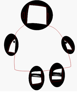

The first MDF layer contains the entire outline. This should be combined (see image of boolean union) with a rectangle for ground stability, since the wheels aren't level. Use a boolean subtract (see image) to remove dirt splash next to wheels and clean up with node editing (see image). As mentioned in the previous step, the wheels and hands are exposed on this layer. After making sufficient copies of the geometry and shifting them out of the way (shift + arrows), delete inner features except for those on hands and wheels.

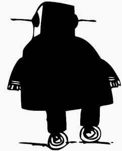

Currently, the fingers are correctly etched (colour not inverted if we reuse the outline for cutting and etching), but so is the entire robot (see image of black robot). Although this will be hidden under the next MDF layer, burnt, rough edges may be visible, and the etching time will be significantly longer. This can be resolved by not using the outline for the etch. Instead, we replace it with a much smaller, simple bounding shape (an oval or rectangle) to act as the new etch boundary (see image of red outline for cutting and black ovals for etching). Now we get some etching of the area outside the robot, but the total etch area (and the etch time!) is greatly decreased.
The centre layer is now ready to be cut and etched.

The other layers follow a similar approach. Note that several duplicates of the rectangular base need to be made to keep the model stable. Notably, the belly slot is exposed one layer below the body. Some top or centre objects, like the buttons and strip, do not use bounding objects for etching but can rather reuse the cut outline as the etch outline. The bottom strip stands out on top of the body layer.
