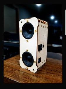

I made a fully laser-cut bluetooth speaker. I suppose the electronics and speakers weren't laser cut.... but the entire casing is laser cut.
I am pretty new to audio circuits and wanted to learn more about speakers and amplifiers. Bluetooth was a pretty cool addition to the project as well. Basically, I used a bluetooth headphone set, fed through an amplifier and finally output through two speakers. The entirely laser cut frame is because laser cutting is fast, looks clean, and is easy to replicate for assembly. Let's dive in!

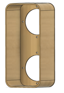

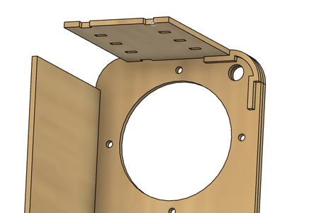

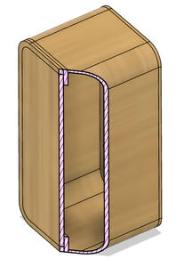

Step 4: Designing the Casing - Speaker Holes and Enclosure
I used fusion360 to design the casing for the speaker. Fusion is cool because its really easy to add dynamic parameters that you can change easily and regenerate the entire drawing. For instance, the speakers I bought were 3 inches diameter. If I bought new ones that were 2 inches or 5 inches, it would be very easy to change that parameter and have the CAD scale automatically.
In the section view (the last picture), you can see how I added a back panel that sits on a thin rim. This is easy access to the inside of the speaker.

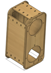

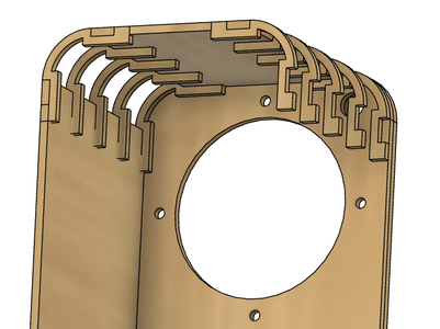

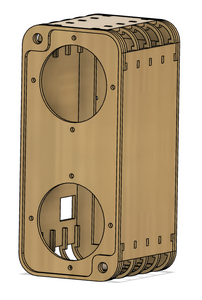

Step 5: Designing the Casing - Laser Cut Joints
The pattern tool was my best friend in this endeavor - I made one joining piece in one corner of the speaker, and from that I was able to pattern it in such a way to get all four edges on the speaker.
I used the project tool and the same patterning to make the accompanying holes for these skeleton pieces.

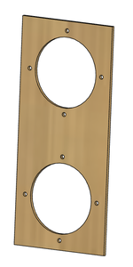

Step 6: Designing the Casing - Auxiliary Holes
I added holes for mounting the battery casings, the amp and the buttons. I also added one finger hole so that it is easy to pull out the back panel.

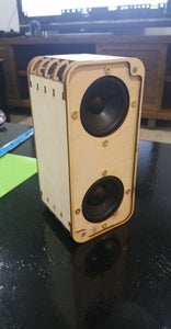

Step 9: Assembly - Top and Bottom Panels
Using the superglue and the smaller, top/bottom panels, glue the skeleton braces in each hole until you have all 20 glued into place.
Step 10: Assembly - Side Panels
Glue the side panels into place as well.
Step 11: Assembly - Front and Back Panels
Glue the front and back panels into place
Note: I did not do this, but you can screw the speakers in place with the 1/4 inch screws to the front panel before gluing the front panel in place. It is much easier to screw to the speakers in this step. I screwed the speakers in after I had assembled the whole thing and it was quite difficult.

You now have a working laser cut Bluetooth speaker!
You can turn it on by flipping the rocker switch and holding the pushbutton for 3 seconds.
You can pair new devices to it by opening the back panel and pressing the down volume button on the actual chip for 3 seconds. It will enter a pairing mode at which point you can find it in your Bluetooth devices in your phone.
