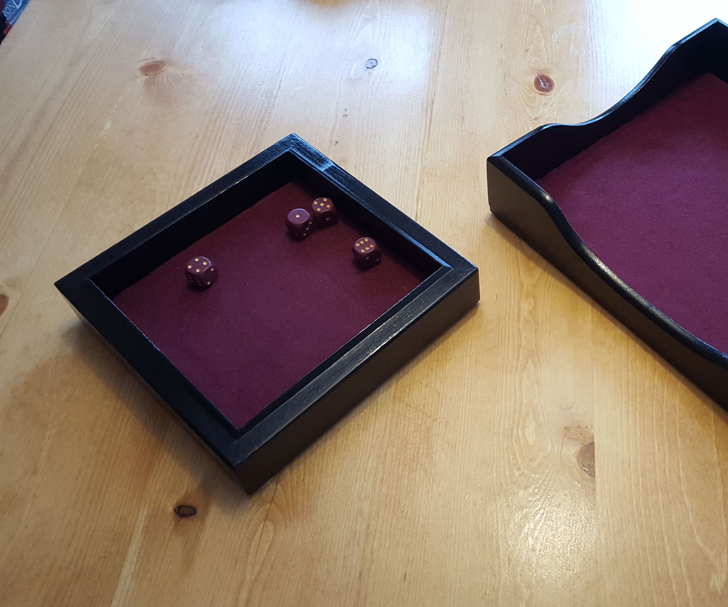

Step 3: Finish
You are nearly done. All that is left is to give your fancy new box a fancy, shiny finish. As you can see from the picture I really like the look of amber shellac. A few coats of it give Baltic birch (really any wood, lets be honest) a beautiful semi-gloss finish. I have given a few of these as presents and I have seen them stained and just clear coated with polyurethane. This is really whatever floats your boat.
To replicate this finish it will take about 4 or 5 coats of shellac so know that if that is the finish you want it is going to be somewhat of a time investment (but oh so worth it).
