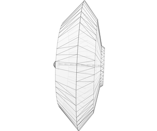

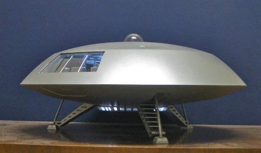

The first step to making a corrugated cardboard model of the Jupiter 2 is to create a 3D model of the Jupiter 2 in 123D.  I started by finding a photo of the Jupiter 2 (second image) and measuring the sides and angles. I then made a 2D outline of the shape of Jupiter 2 (first screenshot).  Using the "revolve" tool in 123D, the 2D outline was converted to a 3D solid model (third screenshot).  Various views of the resulting model are shown in the fourth to eighth screenshots.

The next step is to bring up 123D Make in a web browser and upload the STL model file created in the previous step.  Once loaded, 123D Make will slice the model.  When the model was loaded, the slices were not in the direction I wanted: I had to change the axis for the slides so they would not be sideways (second to fourth screenshots) but horizontal (fifth screenshot).  Various views of the sliced model are shown in the sixth through eighth screenshots.
