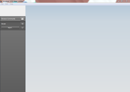

Next I used 123D Make to create the files that will be used in cutting out the cardboard. I used the Windows version of 123D Make for this step.
- I started 123D Make and used the "Import" button to load the STL file created by Inventor as shown in the first and second and third screenshots.
