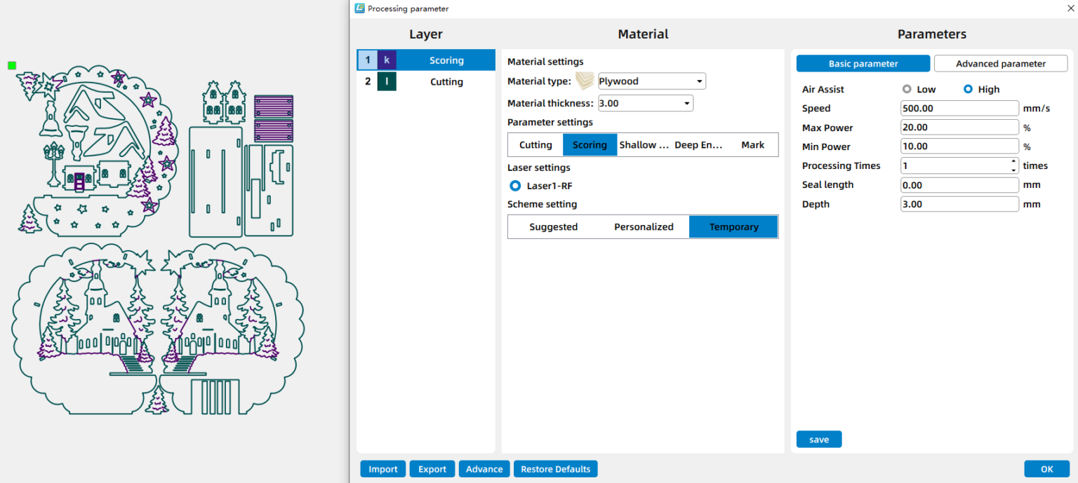

Cutting
  1. Speed:10mm/s
  2. Max Power:25%
  3. Min Power:10%
  4. Number of Passes:1
Shallow Engraving
  1. Speed:500mm/s
  2. Power:20%
  3. DPI:300

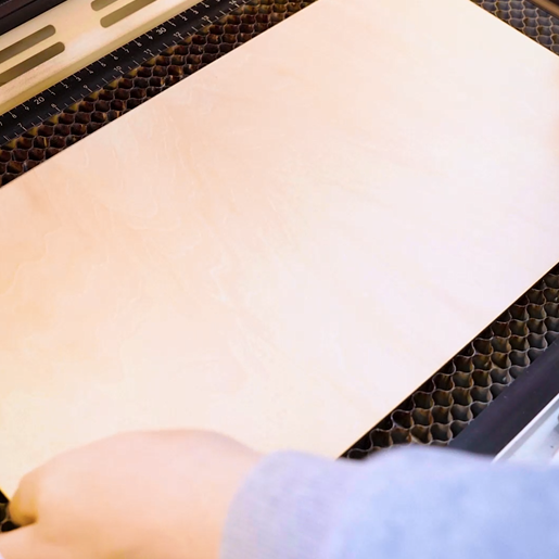

Step 1: Place the Wood on the Laser Bed
Start by laying your wooden board flat on the laser bed. Make sure the surface is clean and sits evenly without warping. If needed, use magnets or light tape at the edges to keep the board from shifting during cutting.
Put the wood material on the table
Step 2: Open the File and Check the Settings
Open your laser software(I use LaserMaker) and import the Christmas desktop decor design file. Adjust the layout so it fits properly within your material size. Before moving on, double-check your engraving and cutting parameters to match the thickness and type of wood you’re using.
parameters for laser cutting a wooden christmas decor

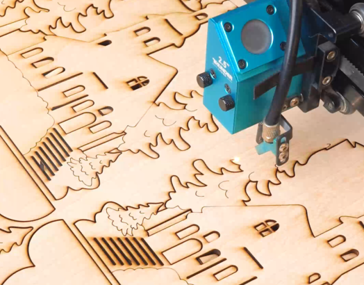

Step 5: Monitor the Laser Cutting Process
Stay close to the machine while it’s running and watch the cutting and engraving progress. Keep an eye out for excessive smoke, small flame-ups, or any movement of the material that could affect the outcome. Make sure your workspace is well-ventilated, and rely on air assist if available to achieve cleaner edges on the wood.

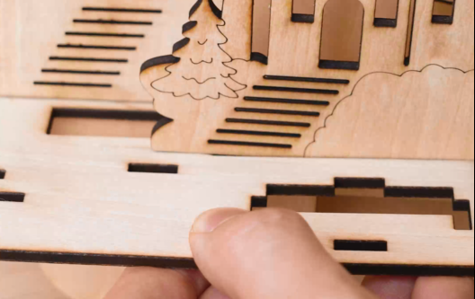

Step 6: Assemble the Decor
Carefully remove the cut pieces from the laser bed. Align tabs, slots, or layers as per the design. The decoration should fit together smoothly without glue for acrylic interlocks, or with minimal adhesive for layered wood pieces.
assemble the christmas decor

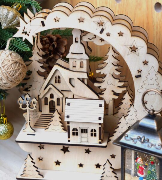

Step 7: Complete the Task
Your Christmas wall decoration is now complete. Hang it on a wall, above a mantel, or near the entrance to instantly bring festive charm into your space.
christmas desktop decor
