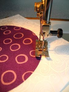

4. Although the fusible web should hold the circles in place, if the quilt is going to be used and washed a lot, I like to reinforce the circles by sewing them down. Use a loose zigzag stitch to sew around each circle. Start and finish with a few straight stitches, very close together, to secure the thread ends. Reduce the pressure on your sewing machine pressure foot to make it easier to follow the curve of the circle. You have now machine appliqued your circles to your block!
