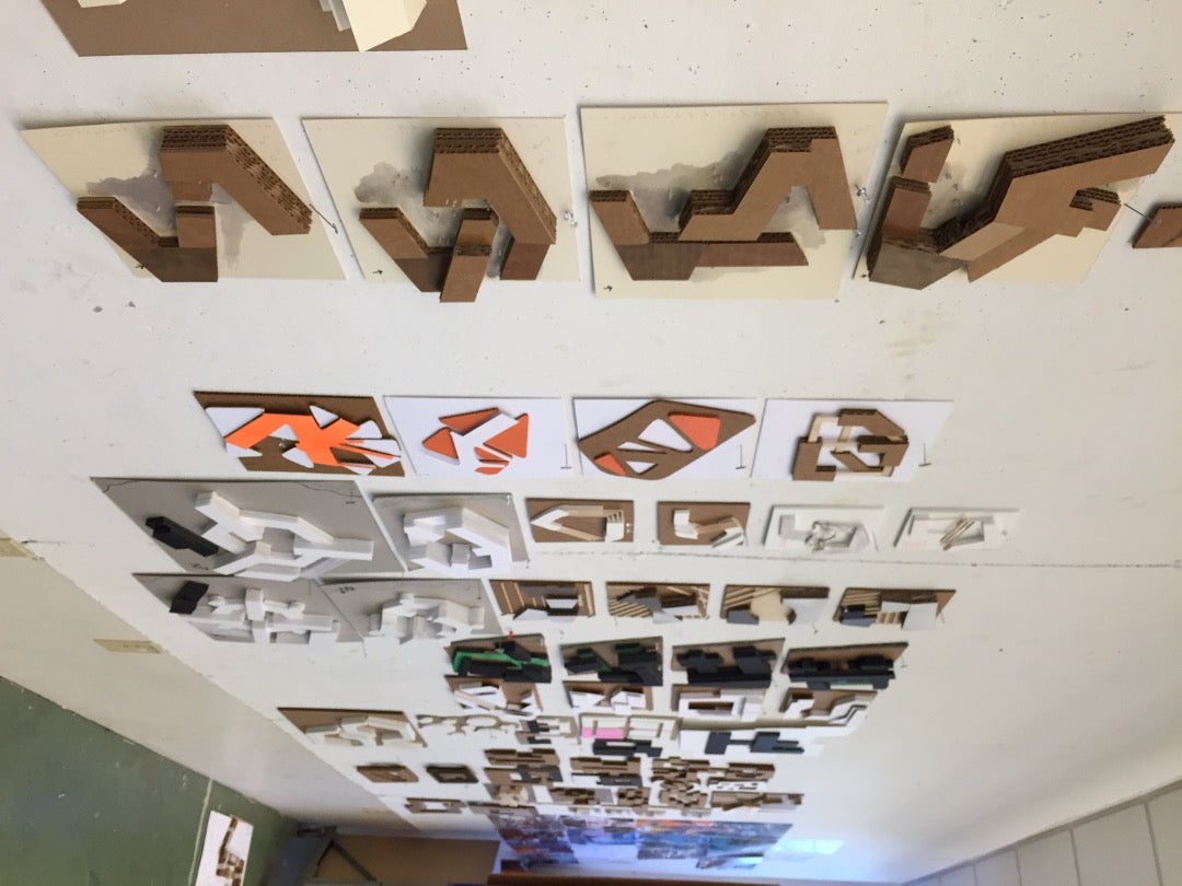

Step 1: Typology Sketch Models
Programmatically intense buildings, from schools, to labs, to housing, often follow particular typologies which help to form a basic formal vocabulary: bars, finger schemes (aka alphabet schemes), and blocks. These typologies form basic primitives that can be adapted into numerous shapes, as well as combined as hybrids. Often typological thinking gets a bad wrap if you take it too literal, instead of understanding typologies as an abstraction to develop a flexible structure. Consequently, start by making numerous small scale study models to get beyond the literal typological thinking.

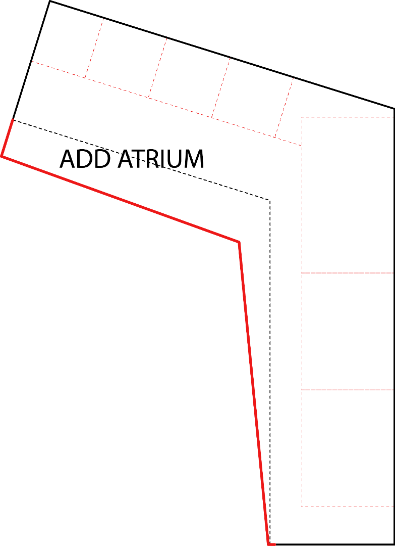

Step 3: Think Spatial
While the plan is a 2d abstraction of space, design with spatial / sectional relationships in mind. In this example, the exterior wall is moved out to provide space for an atrium.

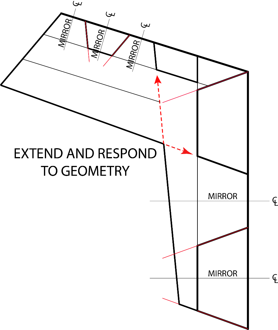

Step 4: Develop Plan With Spatial Relationships in Mind
Evolve interior spaces so they work with overall shape and geometry. With single line drawings, you can develop numerous variations very quickly allowing spatial opportunities to form. In this example, a flexible collaboration area opens up to the second floor circulation, which then leads to open alcoves in a mezzanine at the atrium. Circulation is included with an open stair in the atrium, with space for an enclosed stair at the bottom (this is a two story building so the open stair can act as a means of egress). At the same time the program can begin to break the plane of the exterior massing to make room for larger program, such as the maker space on the first floor, as well as to begin a massing / formal concept, such as cantilevering the second story flex spaces as a transparent volume that is contiguous with the open circulation.

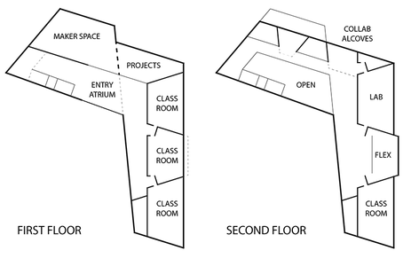

Step 5: Final Plan
By using a few layers to identify line widths, graphic punch can be added in Adobe Illustrator very quickly. These are great for quick schematic plans using line weights to indicate wall thicknesses.

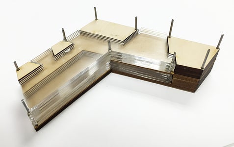

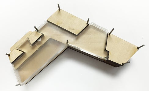

Step 6: Laser Cut Massing Model
The previous plan can be simplified a little more and quickly developed as a laser cutfile. The acrylic can be used to develop the continuous area of circulation space, including open collaboration and atrium spaces. Without being a larger spatial model, the layering of acrylic and basswood hints at the spatial qualities of the atrium, overlooking circulation mezzanine on the second floor, as well as some formal ideas about cantilevering the glass collaboration areas and maker space on the first floor.
But wait! Know your materials and tolerances:
USE CALIPERS to understand precise material thickness.
In this example, 4 layers of 1/8" acrylic equal 3 layers of 1/8" basswood - the 1/8" is nominal size, not actual size.
Thick piano wire is used to align the layers, and in this example is used in approximate locations where structural columns would go. These registration pins should be tight to eliminate layers sliding, but not so tight that they break the material. This takes a little experimentation with the laser cutter to allow for the "kerf" of the laser - a few hundreds or even thousandths of an inch can make all the difference. If you make the circle for the pins as a block in you digital file, then you can do quick tolerance tests on the laser cutter and change all the circles in one go by redefining the block.
