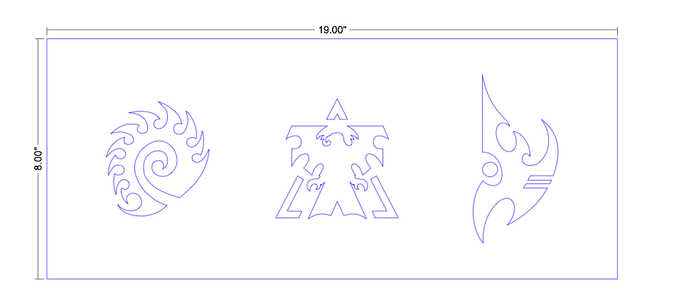

Step 1: Create Your Vector Art
I use Illustrator, but any vector editing program should be able to convert your image to a vector file. A vector file creates your image with lines and shapes based on mathematical expressions. In this way all art in your document is structured in a way that describes solely how the vector should be drawn/cut. This is all done so that your image can be read by whatever machine your using to cut.
1. You should make a copy of your image just in case you make a mistake.
2. Size your image appropriately to your case. That means measure your case! (I made a paper sketch and covered the case and lined everything up)
3. Convert your image to black & white (makes it easier for your software)
4. Use the tracing feature in your software to convert your image to vector lines. Some programs can adjust the sensitivity. (play with the sensitivity until you have the desired result.
5. Touch up your vector art until it is perfect. (delete extra lines and clean up curves)
Adjust the settings to your laser cutter and get ready to cut your image.
