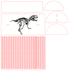

This was my first experience trying out laser cutting, so I made a pretty simple pattern with a few finger joints (that definitely need to be glued to stay together) holding the curved face to the Jurassic backing, an internal divider, flat base, and lid - two layers to fit snugly without sliding. I used a bendable kerf pattern from Aaron Porterfield and dinosaur image from Wall Stickers. I designed for the plywood material that I had available, which was 1/8" thick.
The laser cutter I was using takes input from Adobe Illustrator, but I wasn't familiar with the software so I generated the svg image in Inkscape and set all the shapes and dimensions I wanted, then imported it into Illustrator to set the final line widths and colors necessary for the cutter (these will depend on the machine).
