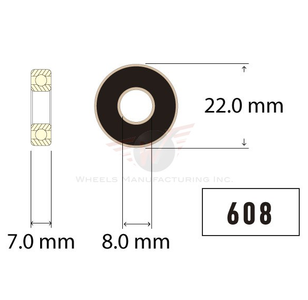

You will only need a 608 bearing which can be purchased very cheaply online.

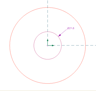

Step 3: Making a Start the Center
For this project it can be designed in 2D so go straight into an engineering drawing .You can design it anyway you want, the only dimension you can't change it the bearing hole of 21.8mm. or 21.9mm if using the large laser cutter
The fidget is made up of 3 pieces of 3mm thick acrylic which are glued together. This step will show you how to make the center piece.

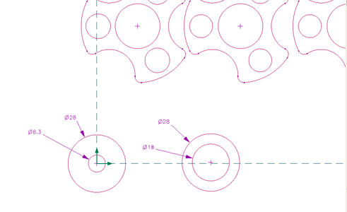

Step 5: The Buttons and Jig, Exporting a DXF File
This step shows you how to make the buttons and a special tool called a jig that will hold the center of the button in place so that it is perfectly aligned.
The button can be any size you want but the center part that pushes into the bearing needs to be drawn at 8.2mm or 8.1 mm if using the large laser.
A dxf file is what the laser cutter needs to cut out the part and this step will also show you how to export your drawing as a dxf.
Again click on the photos and use the arrow keys on your key board to view the side show. its starts with making the jig.
Step 6: Prepairing the Bearing.
Most bearings will not spin very well as they are full of grease. To remove the grease you will need to remove the seals and use a solvent to clean it out. The seals can be remove with a small screwdriver or sharp pick, a quick rinse in petrol or parts cleaner will soon have that bearing spinning freely.
