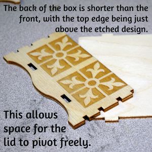

You should have a total of six pieces: two Sides, the Front, the Back (shorter piece), the Lid and the Bottom (with my maker's mark).

The lid on this box is designed to fit into holes on either of the side panels. The two tabs on the lid are cut to the same size as the diameter of the holes, so it will be a VERY tight fit initially. The kerf of the laser and the grain of the material may not allow it to fit without some finessing or some filing/sanding. Try fitting the tabs into one of the side panels and see if you will have to round over the edges of the tabs or enlarge the holes for it to pivot freely. I have not enlarged the holes on the design because some people like the lid to stay partially open and it's easier to sand it off if you don't want that feature than it is to add material. :) Pictured above, I am using a small file to round over the edges of the tabs, but a small, folded piece of sandpaper will work for this as well.
