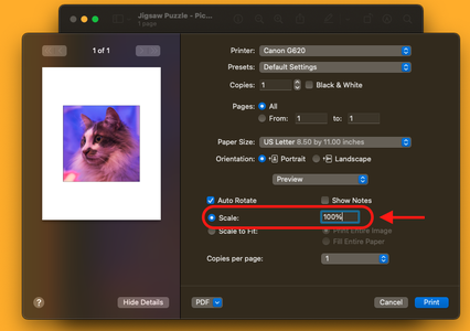

Step 3: Print the Picture
When printing the picture make sure it is scaled to 100% so it matches the size of the blank.
