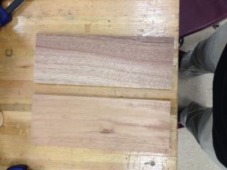

To make my frame I used two pieces of Mahogany wood and glued them together to make my sign 12"x11". I put my wood pieces through the planer and jointed to make the top of the wood smooth, and on side perfectly flat. I then ran them through a table saw to make them each 5 1/2" wide. Using wood glue, I bonded them together and clamped them and let it set for 24 hours. After unclasping them, I ran them through the planer again to make them perfectly even on top and bottom. Then using the Miter saw, I cut the board to 12".
