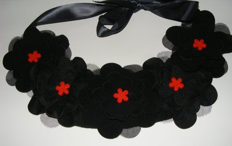

Step 3: The Felt Base
Using the cut file, export the horse shoe shaped necklace backing to your laser cutter (or print at 100% scale and cut by hand)
Step 4: Attaching Ribbon to Felt Base
Attach the ribbon to the felt base by either a sewing machine as we did, or alternatively use a needle and thread. Another alternative is to use fabric glue.
At this point sew the ribbon on the outward facing side as where it will be stitched will be hidden by the flowers and make it much more comfortable to wear.
We cut the ribbon into 50cm lengths (20 inches for non metric measurement) but adjust to what feels comfortable, we also heat sealed our cut edges to stop any fraying

Step 5: Laser Cutting Material Flowers
Choose you materials carefully, we used a felt base for our largest flower, then repeated the same size flower with net.
Play around with your materials to find an order that works best for you.
using materials with natural patterns and alterations creates a more natural feel.

Step 7: Assembling the Material Flowers
Layer up all your petals starting from the largest on the bottom to the smallest on the top, alternate petals so that you have a nice natural flower look.
Align the petals to the center dots, you can use what ever you like from a paperclip to your eyes!

Step 8: Sewing the Assembled Petals
Stitch the petals together in center either side of the center dot, use cross stitches to hold it together and cast off at the back when your ready.

Step 9: Glue the Acrylic Flower to Petals
Glue the acrylic flower to the center of the fabric flower with the hot glue (or glue of choice) being careful to not have any over spill or strings!
Step 10: Glue the Complete Flowers to the Felt Necklace
Glue the flowers to the felt using the center dots as a guide starting from the outside and working towards the center.
