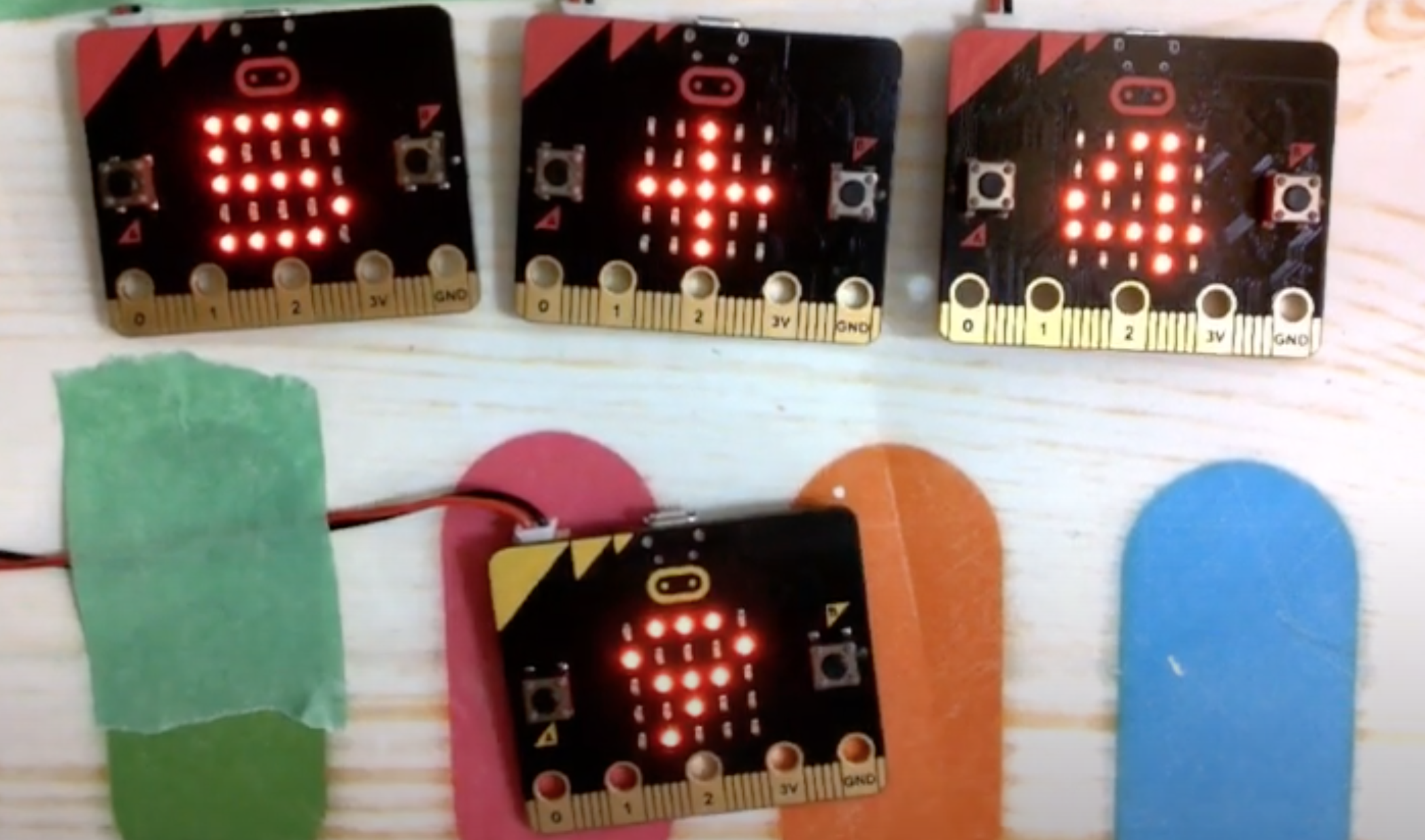

Step 4: Code the Micro:bit
For this step, it will depend on the LEDs you have - this step is for using just the micro:bit. The next step is using some external LEDs. (another option could be to use a combination of both!)
To code the micro:bit you can head over to makecode.microbit.org and create a new project. These projects stay in the cache of the browser so the suggestion would be to save them on your computer for future use.
If you have just the micro:bit - you can use the red LEDs in various patterns.
Glowing - gradual lighting on and off. (See demo code on the left)
Blinking - on and off (See demo code on the right)
Once you have tested the code on the simulator on the site, you can download it to the micro:bit using the USB cable.
