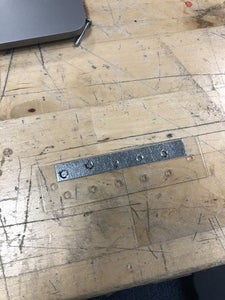

  • To create pressure distributing sheet metal strips you will need to cut 2 pieces of sheet metal
    • The strips should be approximately 1 cm by 7.5 cm
  • Align the cut sheet metal with the laser cut acrylic pieces and use a marker to draw a dot where each acrylic hole lines up as pictured
    • These are where the screws will go
  • Use hand punch to punch through the marked holes
    • If the metal strip is obstructing the step part of the geometry, punch out a half circle to create window for the step

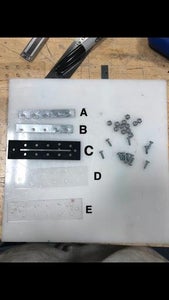

Make sure you have all pieces pictured before assembly.
  • Layer the sheets in the following order going from the bottom and working up: acrylic sheet with exit/entrance holes (part E), rubber sheet (part C), acrylic sheet base (part D), and the metal sheets on either side of the channel (part A and part B)
    • Ensure that all of the holes line up through all four layers
  • Place the screws in each hole, they should be placed going in the opposite direction of the assembly, then place the nuts on the screws (screw head should be on part E, the nuts should be on parts A and B)
  • Tighten the nuts slowly and carefully to minimize deformation
    • Do not fully tighten one screw then move on to the next, tighten each screw little by little and work diagonally from your previous nut, similar to the way a tire is tightened
  • Pictured is a cross section of the assembled chip. From top to bottom the layering goes part E, part C, part D, and parts A and B
