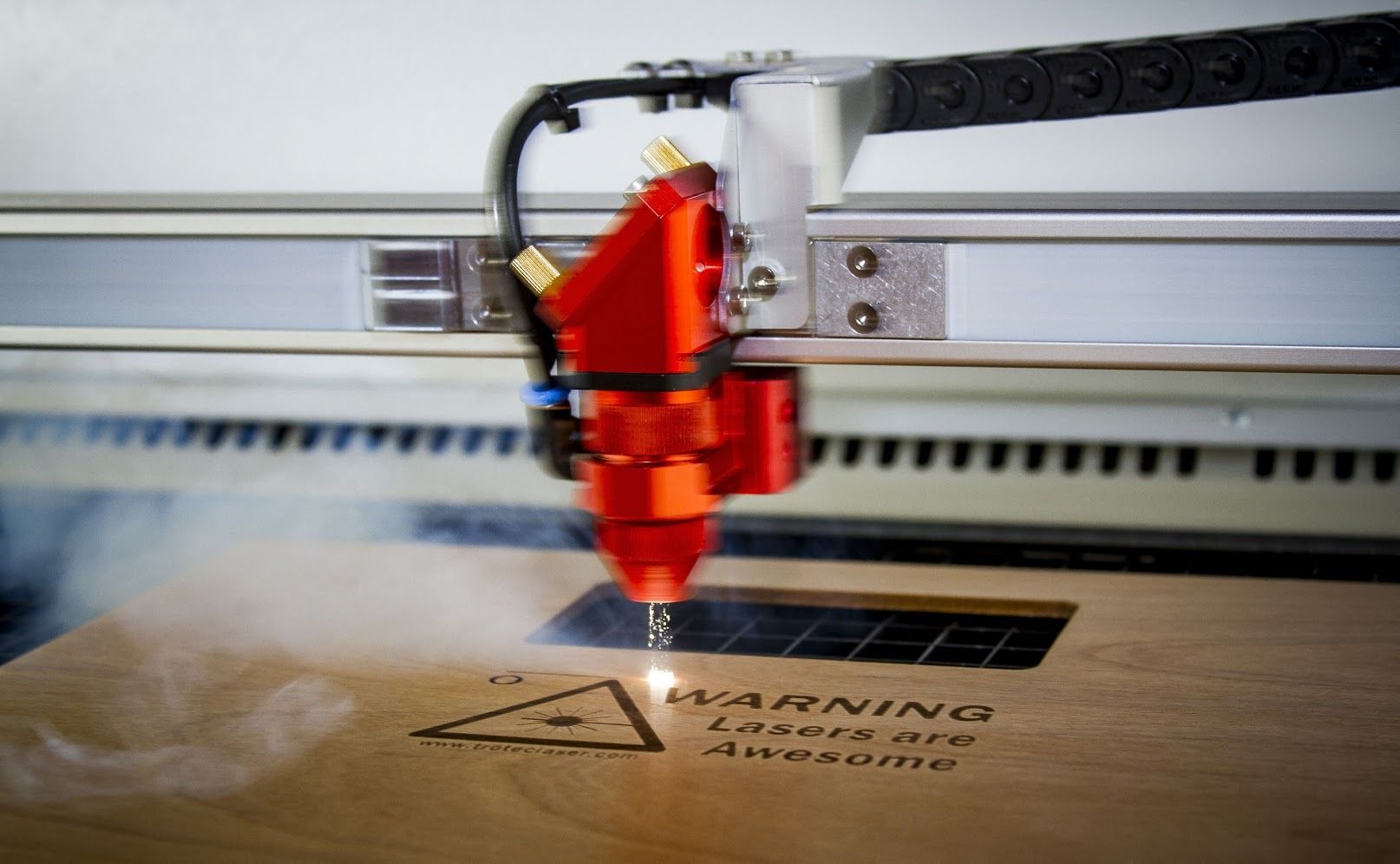

Step 1: Process the Acrylic
Position acrylic into the laser machine and cut the material using the file provided. Once processing is completed, remove the cut pieces from the remaining material.
Laser Parameters*
  • Color: Red
  • Process: Cut
  • Power (%): 100
  • Speed (%): 1.0 for 1/8" (3mm), 0.6 for 1/4" (6mm)
  • ppi/Hz: 1000 ppi
  • Passes: 1
  • Air Assist: Yes
  • Z-Offset: No
  • Advanced: None
*Use these settings as a guide but make sure you adjust your settings if you have a machine with a different wattage.
