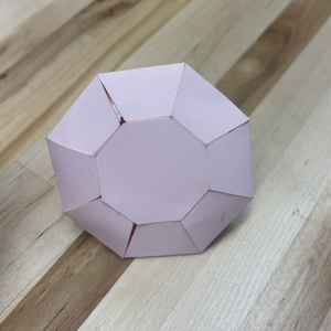

Here is my paper form of a gem!!!
For this project, I used pink cardstock, Fusion, Adobe Illustrator, and the laser cutter.

Step 5: Folding and Final Outcome
Finally, I folded everything together and taped the flaps I had made. The flaps actually worked well, and it was pretty easy to shape overall. I just wish I had printed it larger; it was tiny and tricky to handle, so it didn’t come out as clean as I wanted. If I had more time, I’d go back into Fusion and tweak the top so it pops out more. I can totally imagine making a bunch of these in different sizes to hang from the ceiling or even as jewelry store decorations. This reminded me of the reading and how I can create 3D models using materials around me rather than using plastic. This would help me a lot to use this as a prototype to make sure I only need to print my final project once. This helped me understand that we can design with limits, which I also learned from the reading "Print Green". This project made me realize we can design while being mindful of our resources. Before this project, I would initially always think of 3D printing objects before even looking at laser cutting as an option. Overall, this project gave me a much better feel for both Fusion and laser cutting, and it was super fun to experiment with!
